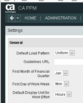

The display setting hours/days is in Administration - Project Management Settings
