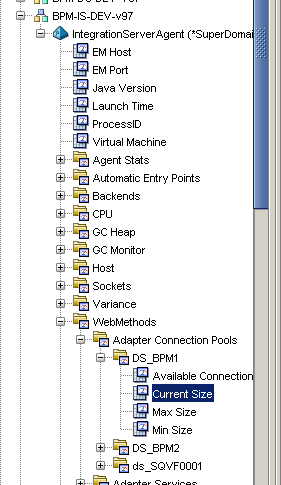

I want to add a new metric, I have this structure
And I need to add a % metric calculating between Max Size and Current Size

It doesn't make errors but don't show metrics too. Actually metricData.length = 0. Do you see some error or mistake in this code?
