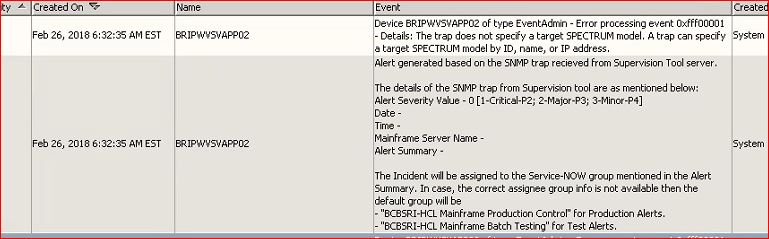

    I am facing a problem with Spectrum application. The SNMP traps coming from a third party integrated application is not converted in Alarms. Error screen shot below.
    Event error in spectrum
    When I did some R&D using wireshark application, came to know... the traps are missing some octet string of the OIDs in the RAW traps. I am attaching an image for reference. Can anyone help me to understand, what can probably cause that.
    I have highlighted the data, which could be cause of the issue.

    Hi Saju,
    You will need to check on the SNMP agent installed on the device/host IP: 10.50.20.196.

    Hi Silvio,
    Yes, you were right the SNMP service on the windows machine was having issues. The reboot of the server fixed it.

    Posted Feb 28, 2018 01:15 PM
