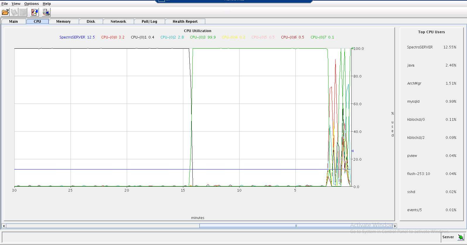

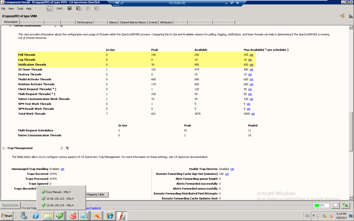

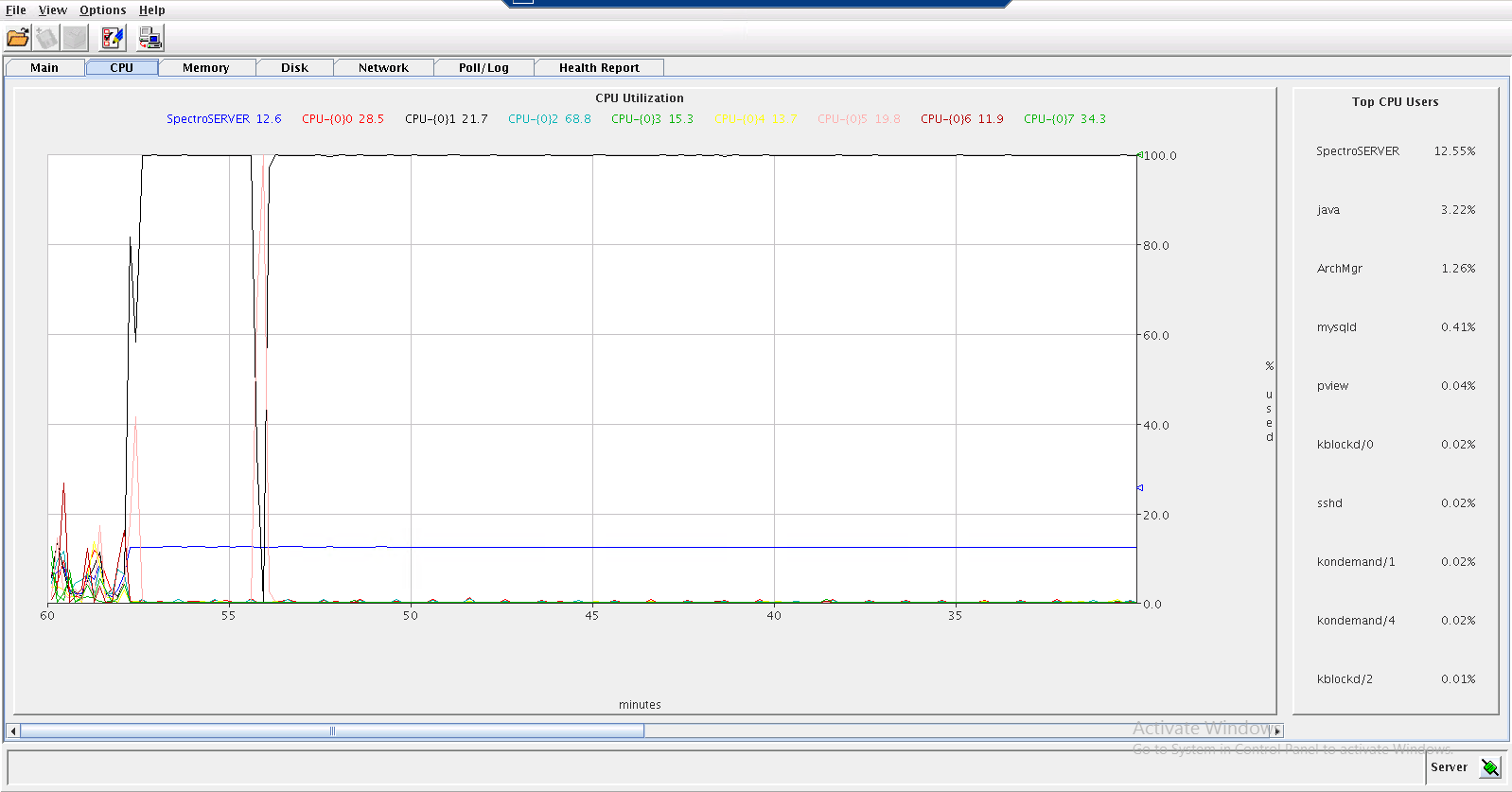

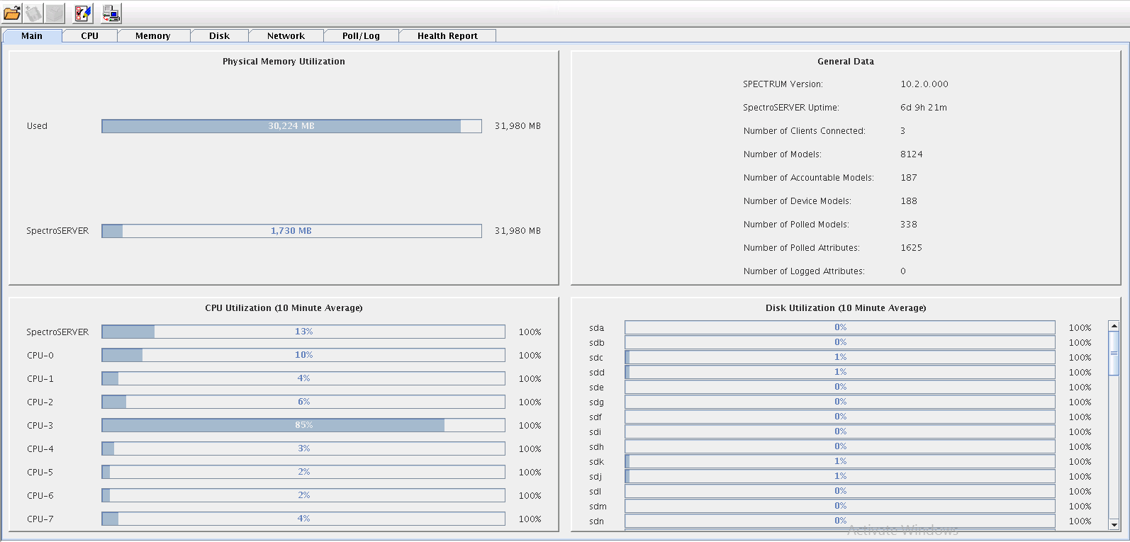

    I noticed the following when the CPU rises in the Performance View.
    The Poll Threads In Use are raised to the maximum.
    There are only 188 devices.
    When I stop the SS it looks like the next image.
    Thanks very much Veronique
