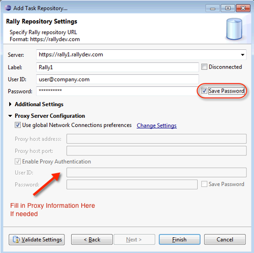

    Rob - after entering server settings (which should be "https://rally1.rallydev.com") and credentials, you might try the "Validate Settings" button just to make sure things are set up properly.  It's at the bottom left of this screen:
    0EM140000004bia
    Another thing you might check is the user permissions of the integration user.  Make sure the user has at least "Viewer" permissions for a workspace/project, but you might even try "Editor" permissions.
