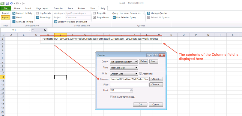

    Hi there, to correct my above post:
    Though the fields you noted do not appear in the selection option for columns, you can type these into the Columns field to return the data you are looking for.
    I have included a screenshot to illustrate how this is done.
    0EM140000004hsl
    Unfortunately, this is the only way to get the test steps and be able to see the Test case they are associated to.  When exporting test cases, the test steps are not part of the export.

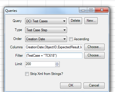

    Posted Apr 10, 2015 12:54 PM
    Hi John,
    I was able to get that working by inputting steps. But when i try to export few test cases, i am actually getting the error.
    Cannot parse object reference from "TC618"
    Thanks,
    Monica

    I am using the Rally add-in for excel.
    I selected a workspace and a project and trying to export all test cases in that project. But i dont see all the test cases  being exported. Some of them are missing from the list exported even when the test case is tied to the project i selected.
    So, i tried to filter on that specific test case thats missing and get the error.
    0EM140000004lgy
  • 18.  Re: How do I export test steps for a group of test cases?
    Posted Apr 10, 2015 03:20 PM
    Monica, it looks like the problem is that your query syntax is incorrect.  If you're trying to reference the Formatted ID of the Test Case, try this instead:
    (TestCase.FormattedID = "TC618")
