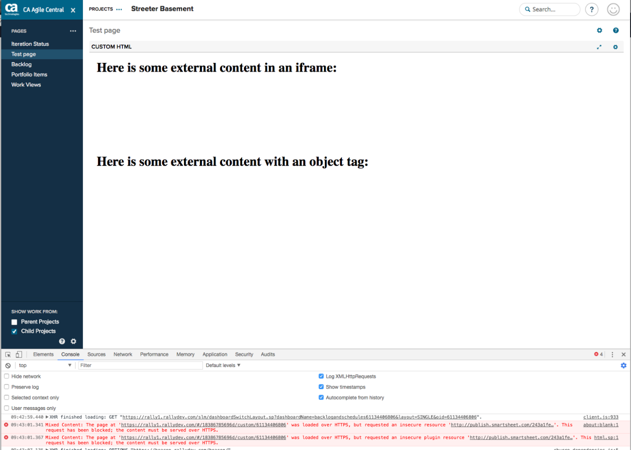

    Thanks. I have a Custom HTML app. Here's HTML that I've pasted in:
    <h1>Here is some external content in an iframe:</h1>
    <IFRAME FRAMEBORDER=0 SRC="http://publish.smartsheet.com/243a1fef864b44e6b29715c07ac3d7ca"></IFRAME>
    <h1>Here is some external content with an object tag:</h1>
    <object type="text/html" data="http://publish.smartsheet.com/243a1fef864b44e6b29715c07ac3d7ca" > </object>
    The result is that I can see the header text, but I can't see the external content that I'm trying to share.

    MarkArmantrout1358389 yep, the reason is because trying to load content from an insecure site over HTTP is blocked from within a secured domain (HTTPS). No browser will allow that to happen unless you disable some security settings, which I would not recommend!
    Here's what I get in the browser console when I try to use that HTML:
    Mixed Content: The page at 'https://rally1.rallydev.com/#/18386785696d/custom/61134406806' was loaded over HTTPS, but requested an insecure resource 'http://publish.smartsheet.com/243a1fef864b44e6b29715c07ac3d7ca'. This request has been blocked; the content must be served over HTTPS.
