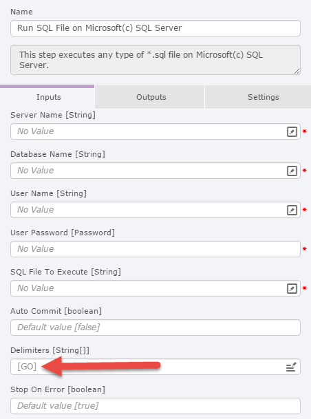

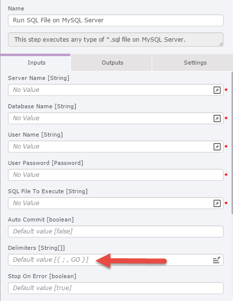

    By any chance, are you including the following delimiters? Usually the scripts only include the "GO" delimiter, so just change the value as pointed by the red arrow to just include the "GO" delimiter and your script will execute.
    Thanks
    -Walter

    Was your RA action delimiter setup like this?
    Please keep in mind that the RA Execute SQL script for MS SQL is not design to develop/debug a SQL script. If you are looking for the output of the action, you should had gotten it once the action has executed and also in the RA agent, please look at the nolio_all.log file.
    Thanks
