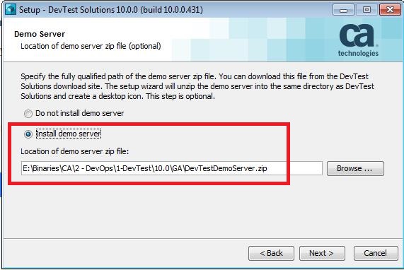

    For installing the DevTest Demo Servers see Installing the DevTest Demo Server in our product documentation.
    For your convenience:
    When downloading the DevTest product installer from CA Support Online you also have the option to download the DevTest Demo Server zip file. The DevTest Demo Server includes two Demo applications, LISA Bank and Forward Cars.
    From Download Center in CA Support Online
    After downloading this Demo Server and unzipping the downloaded file, you will get another zip file, called DevTestDemoServer.zip. You copy this zip file to the same folder where your DevTest product installer binary (and the license file) is located. If you start the product installer, you will be offered the non-default option to install the demo server
    Installer option to install the demo server.
    and the location of the DevTest demo server zip file is preset. Continuing the setup wizard will install the demo servers Lisa Bank at LISA_HOME/DemoServer/lisa-demo-server and Forward Cars at LISA_HOME/DemoServer/carsdemo.
