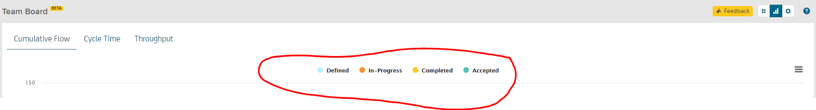

    Posted Jan 02, 2018 03:10 PM
    Below is a picture showing my SCHEDULED STATE's.  If mine looked like yours, showing flow states, that would help a lot.
  • 6.  Re: How do I extract FLOW STATE
    Broadcom Employee
    Posted Jan 02, 2018 04:02 PM
    If your board has different flow states, but that chart is giving the options as schedule states, then I think you've got an issue that Support could help with. You can contact them via Agile Central with "Support" in the bottom black bar or "Contact Support" under the "?" icon in the upper right if you have no black bar at the bottom.
  • 7.  Re: How do I extract FLOW STATE
    Broadcom Employee
    Posted Jan 03, 2018 01:48 PM
    It's not just ScottyD- every Team Board that I look at shows the CFD strictly by Schedule State.
