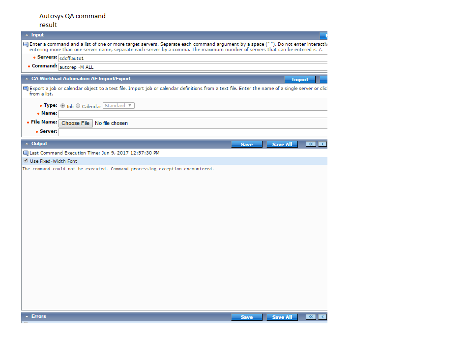

    Autosys QA command result
    Autosys QA command resultHello,
    Thanks for your reply. We're just new to Autosys application and haven't much knowledge. Now, our issue is we cannot execute a command in our Autosys QA but we're not having issue in PRD. Is it an authorization issue? Could you please help how we can fix this?
    Attached are the screenshots.

    Hi,
    Your guess is right, it could be an authorization issue. A valid credentials for the WCC User in the Credentials Application [ tab ] should be mapped. This user credentials will be used to access the WAAE Application Server to execute the commands (Means a valid OS login). Add and validate the user. If that resolves the problem for the current user, you might want to update "_GLOBAL_:  <user_id>" credentials, to set the default  credentials all the users.
    Thank You!

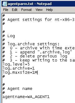

    Hello Chandru,
    I was able to locate the agentparm.txt file and identify the "agentname" parameter. Upon looking in Autosys, the machine name that we are using is .
    I would like to confirm if this is the machine definition that you mentioned? If not, any chance you would know where I could locate it?

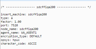

    If you execute command `autorep -M sdcffiqa200 -q`, you'll see an agent_name attribute in there. We need to ensure this matches the agentname parameter value in the agentparm.txt.
    Thanks,
    Chandru

    Hi Chandru,
    As per checking, agent name defined in the machine sdcffiqa200 is the same as the one in the agentparm.txt.

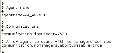

    Ed,
    Do you have multiple System Agents installed on sdcffiqa200? If yes, then it is likely that the Agent listening on port 7520 (communication.inputport parameter in the agentparm.txt) has a different name than WA_AGENT1. Please check the agentparm.txt for WA_AGENT1 and see what port it is setup to listen on.
    Thank you,
    Chandru
  • 17.  Re: SAP and Autosys Connection
    Posted Jun 29, 2017 02:52 PM
    Hi Chandru,
    There is only one system agent installed. Also, as to how I see it in the agentparm.txt seems like it matches the communication port configured in sdcffiqa200. Please see below.

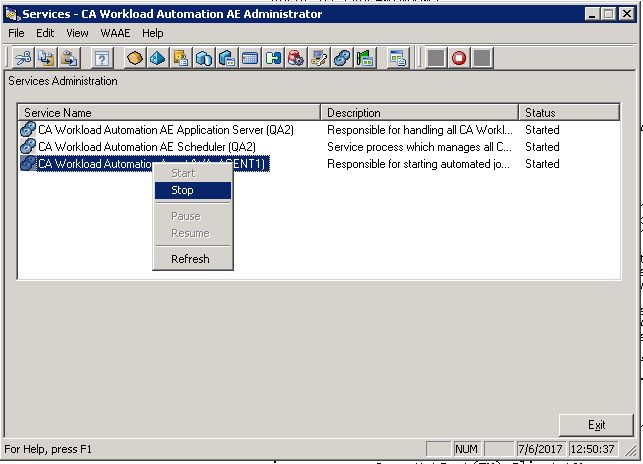

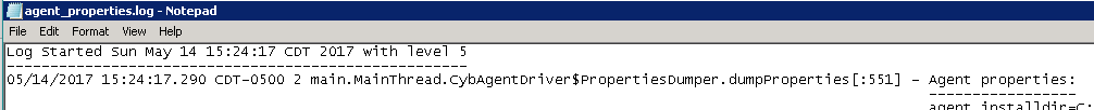

    Hi Ed,
    Please restart the WA_AGENT1 service and see if it improves the situation. Forward the agent_properties.log.
    Else, please open a Case with CA.
    Thanks,
    Chandru

    Posted Jul 06, 2017 01:51 PM
    Hi Chandru,
    I've been trying to restart the agent but it is not working. Restart is also not reflected on the agent_properties.log

    Posted Jul 13, 2017 02:29 AM
    Remember this is the SAP plug-in, which means that you can have a separate "agentname" for this plugin.  Thus you can have 2 agentnames even when only 1 system agent is installed.  In the SAP plugin section of the agentparm.txt file you need to check if a different agentname has been specified.
    Regards, Andrew
