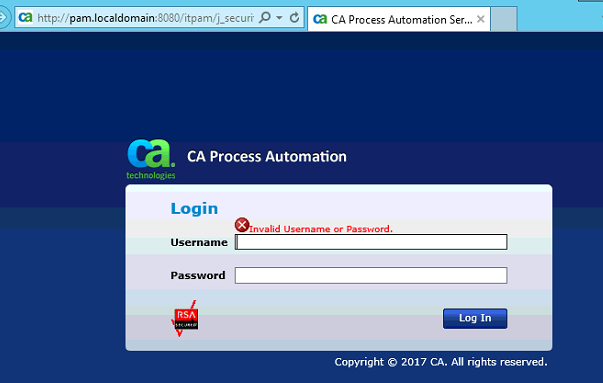

    1. Whats the Username to login ? I didn't remember anywhere it asked while installation. However I put Administrator , ServiceDesk & CASMAdmin but not worked

    If Ad is already configured in eem, You have to enter process automation application on Eem and add the domain user with the Profile that you want.
    If it's not, Pam creates a local user pamadmin.

    No , RIghtnow AD is not configured in EEM. I tried pamadmin just now but still not able to login.

    So if AD is not setup eem will use pamadmin, with the default password pamadmin. Check this link, ,it will show how eem will be first configured.
    Example: Configure the Existing Installation to Regenerate Certificates - CA Process Automation - 4.3 - CA Technologies …
