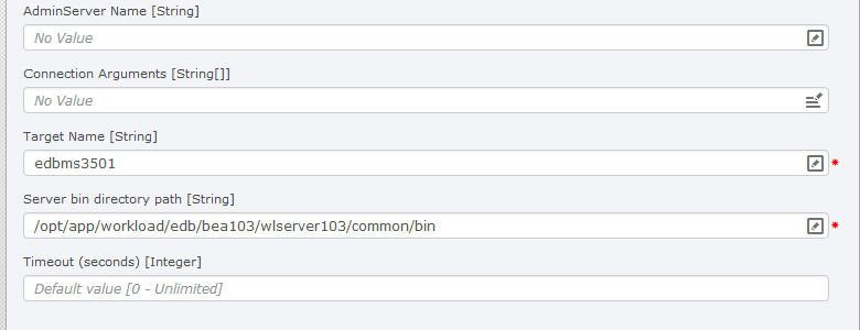

    The agent is running on the Unix server and the version of the weblogic action pack is 10.12.1508.2. Please find the snap shot for your reference:
    Please let me know if any more information is required.
    Thanks
  • 15.  Re: How to work on WebLogic Actions

    Posted Apr 18, 2017 01:42 AM
    Can you also verify the that weblogic jar exist in the agent actionslib directory
