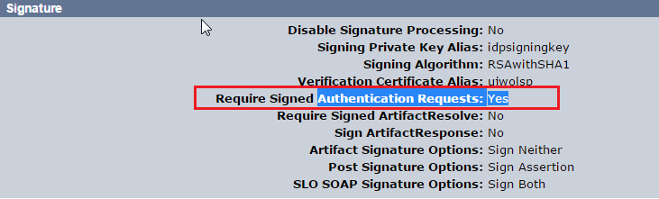

    Hi Teja,
    I was able to replicate the issue in my lab.
    It seems that you have Signed Authentication request requirement set to YES at IDP :
    However, the AuthnRequest sent by SP is not signed.

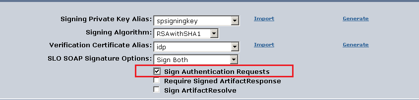

    Solution :
    Configure SP to sign AuthNRequest. If SP is CA SSO you can do this as below on SP side of partnership :
    Let me know if this works for you.
