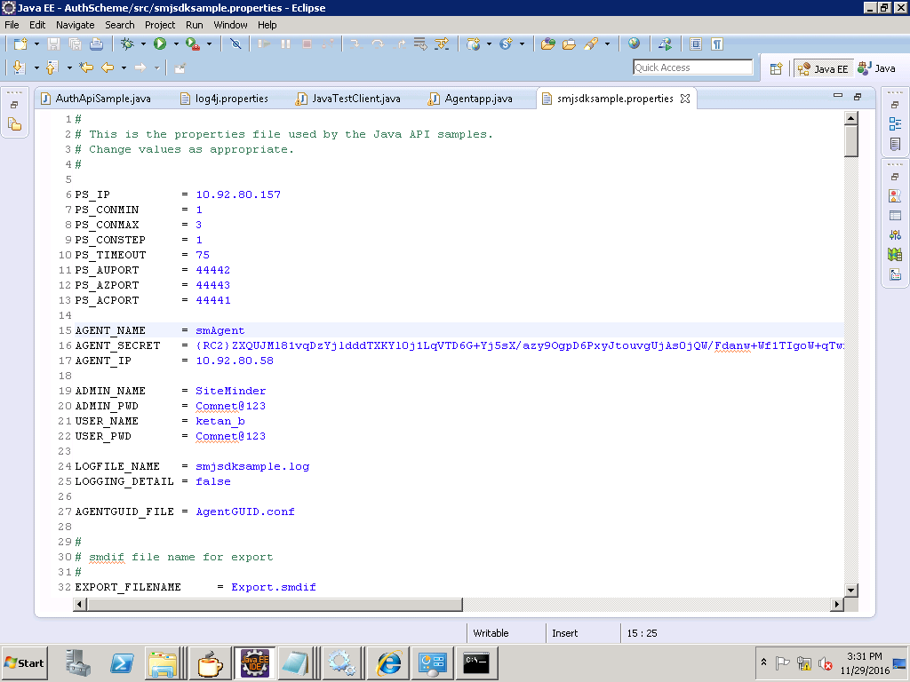

  • 4.  Re: CA Single Sign On Java Agent API
    Posted Nov 28, 2016 05:11 AM
    Hello,
    Are you trying to run the sample agent provided ?
    If so then you are using a 4x agent to connect to PS
    > This 4x agent needs to be created according to smjsdksample.properties
    AGENT_NAME     = ***
    AGENT_SECRET   = YYY
    AGENT_IP       = xx.yy.***.www
    You can also use smHost.conf to connect to PS.

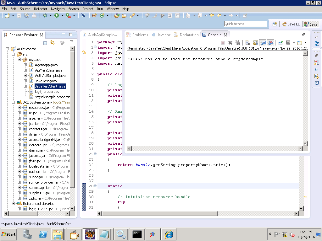

    Yes I am trying to run the sample agent provided but with agent 12.5X.
    It says "Failed to load the resource bundle smjsdksample"

  • 6.  Re: CA Single Sign On Java Agent API
    Posted Nov 28, 2016 05:52 AM
    Hello,
    Share the smjsdksample.properties and check the AGENT_NAME, AGENT_SECRET, AGENT_IP used in your environment. You would have to create an agent 4x (using the adminUI) with the same information.
    Julien.

    You need to keep smjsdksample.properties file in the classpath.

    I placed the smjsdksample.properties in my src folder.errorfile
    I means that the file is having missing resource exception.
    Please help it out.

    I'm not using eclipse but command file.
    1. to compile : C:\Program Files (x86)\CA\sdk\samples\smjavaagentapi\java-build.cmd
    javac -classpath ..\..\properties;..\..\java\smjavasdk2.jar;..\..\java\smjavaagentapi.jar JavaTestClient.java
    2. to run : C:\Program Files (x86)\CA\sdk\samples\smjavaagentapi\java-run.cmd
    java -Djava.library.path=..\..\bin -classpath .;..\..\properties;..\..\java\smjavasdk2.jar;..\..\java\smjavaagentapi.jar JavaTestClient

  • 13.  Re: CA Single Sign On Java Agent API
    Posted Nov 29, 2016 04:59 AM
    the properties file is inside your package not within src folder directly.
    Try moving it to src directory.

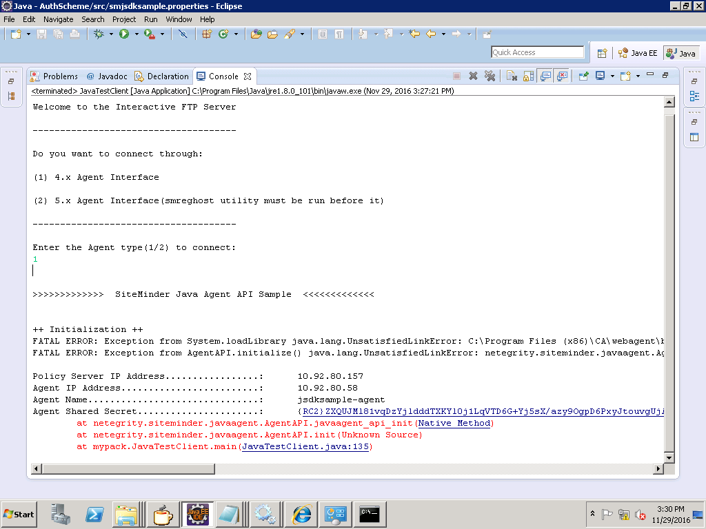

  • 15.  Re: CA Single Sign On Java Agent API
    Posted Nov 29, 2016 05:27 AM
    FATAL ERROR: Exception from System.loadLibrary java.lang.UnsatisfiedLinkError: C:\Program Files (x86)\CA\webagent\bin\smcommonutil.dll: Can't load IA 32-bit .dll on a AMD 64-bit platform
    FATAL ERROR: Exception from AgentAPI.initialize() java.lang.UnsatisfiedLinkError: netegrity.siteminder.javaagent.AgentAPI.initialize()V
    Policy Server IP Address.................: 10.92.80.157
    Agent IP Address.........................: 10.92.80.58
    Agent Name...............................: jsdksample-agent
    Agent Shared Secret......................: {RC2}ZXQUJMl81vqDzYjldddTXKYl0j1LqVTD6G+Yj5sX/azy9OgpD6PxyJtouvgUjAs0jQW/Fdanw+Wf1TIgoW+qTwfNLpjc0cKLYyBLHF4iHGGTR9AqDmjMncAM2lmcHGwYnDiN0CdDhydJLMP8MZzTHH7xnT/k7903PBr6mo86k3cNa51BP3i2S5E1Mud5hbL0Exception in thread "main" java.lang.UnsatisfiedLinkError: netegrity.siteminder.javaagent.AgentAPI.javaagent_api_init(Lnetegrity/siteminder/javaagent/InitDef;)I
    at netegrity.siteminder.javaagent.AgentAPI.javaagent_api_init(Native Method)
    at netegrity.siteminder.javaagent.AgentAPI.init(Unknown Source)
    at mypack.JavaTestClient.main(JavaTestClient.java:135)
    This is the complete error I am getting.
    If you can help it out.
  • 16.  Re: CA Single Sign On Java Agent API
    Posted Nov 29, 2016 05:35 AM
    Hello,
    1. there is a problem on loading libraries :
    > Please use C:\Program Files\CA\webagent\win64\bin\smcommonutil.dll to use 64 bit libraries.
    2. Regarding the agent name, from the code:
    String agentName = getStringFromBundleWithTrim("OBJNAME_PREFIX") + "agent";
    in the smjsdksample.properties :
    OBJNAME_PREFIX        = jsdksample-
    > So you agent name will be jsdksample-agent
    > To change it use : String agentName= getStringFromBundleWithTrim("AGENT_NAME");
    Hope it helps,
    Julien

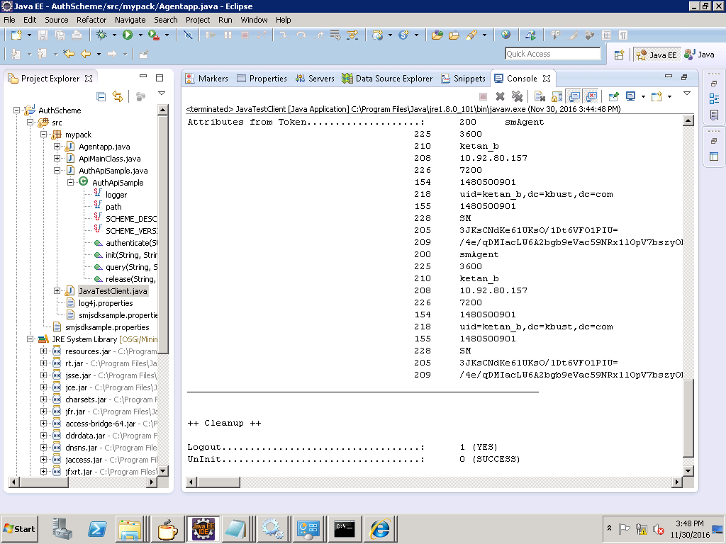

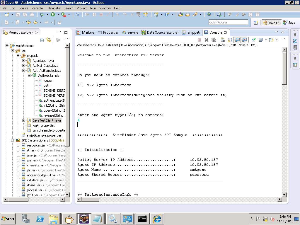

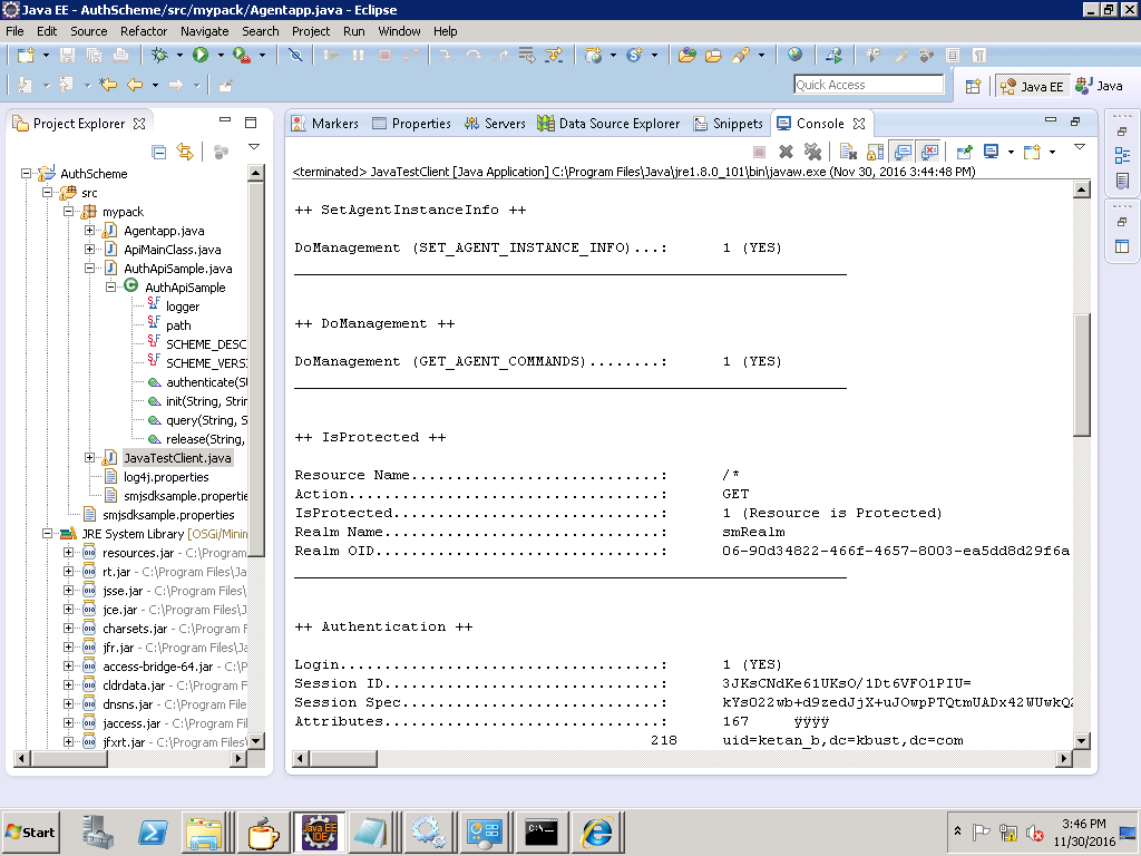

  • 20.  Re: CA Single Sign On Java Agent API
    Posted Nov 30, 2016 05:42 AM
    Hi Ujwal,
    Thanks for the help now my agent api is working as :
    Now I want each of these encrypted attributes to get decrypt so that I can fetch its values.
    Please help it out.

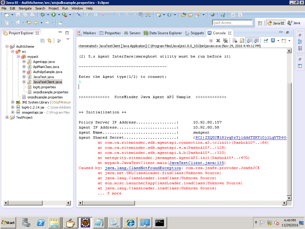

  • 21.  Re: CA Single Sign On Java Agent API
    Posted Nov 30, 2016 05:56 AM
    Please mark this thread as answered and open new thread for your new question.
