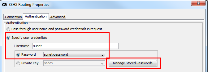

    If you are looking to send a file to be passed from the frontend to the backend SFTP server you will need to setup a Listen Port for SSH2 with a private key on the Gateway which it appears you have done. The available commands allow will be important from the back and forth communication. On the Route to SSH2, will need to have either the private key or password entered into the Manage Stored Password interface. Which are you using private key or password?

    I am trying to do the simple case. I receive SOAP requests, transform the message and want to write the resulting XML files to an SFTP server. I was not able to get the file transfer running with username/password authentication. I created a "stored password" and simply use it in the "Route via SSH2" assertion on the authentication tab. I also checked the flag "Validate Server's Host Key" and inserted the host key. But even when I disable the checkbox it does not work.
    When I send a request the policy fails with "WARNING 9434 SSH routing error: Failed to retrieve ssh session: Auth fail".
