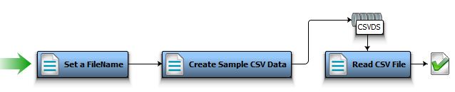

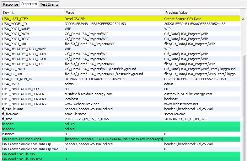

    Hi Jason, I tried a scenario similar to yours and it seems to work.  Following is an example using DevTest 9.1.  My sample model is as follows:
    - The Set a FileName step does nothing more than store a file name into a filter called "fl_fileName".
    - Create Sample CSV Data does multiple things.
    The Parse Text as Response step places a comma delimited file (header1 & header2, colVal1 & colVal2) into a property called "fl_csvFileData".
    Then a Timestamp filter creates an "fl_time" property with a date/time.
    Followed by a Save Property Value to File filter using
       - the fl_csvFileData as the Filter In value and
       - the Location of: {{LISA_RELATIVE_PROJ_ROOT}}/Data/CSV_DATA/{{fl_fileName}}_{{fl_time}}.csv
    - The Read CSV file, opens the dataset using a File Location of:  {{LISA_RELATIVE_PROJ_ROOT}}/Data/CSV_DATA/{{fl_fileName}}_{{fl_time}}.csv
    When I run this model in ITR mode, I can see that DevTest creates the data, saves the file, and the dataset consumes the first row.
    I attached the sample test case in case it helps.  I would start by checking the reference to your file location or file name.  Perhaps an upper/lower case character or location may be creating an issue for you.

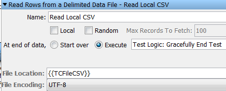

    Java code in this script create the file, I see the property created with the correct path/file and I'm able to copy path and open the file in ITR as I step through.
    2) In the 2nd step, I try to read the file I created from the property I set in the first step
    I see that you're parsing the property in your example. Is that what I'm missing, something that loads the property before a step tries to use it?

    Not sure about the behavior in 8.2.x...  I think the issue may be with the direction of the slashes in the path...  As a test, I dumped using the relative project root and created a Config property having a key/value pair of:
    FILE_PATH     C:\\_Data\\LISA_Projects\\WIP
    Then, I used this code in a script to build the file location before saving and reading the CSV file.
    String myFile = "{{fl_fileName}}_{{fl_time}}.csv";
    testExec.setStateValue("fl_path", "{{FILE_PATH}}\\Data\\CSV_DATA\\" + myFile);
    Concatenating the path with a Config property was unnecessary.  I was playing a bit with how DevTest deals with properties inside strings to make sure conversion was not an issue.
    I believe switching the "/" to a "\\" as a directory separator was the import part.
    Attached is a version that uses the fl_path property to save the CSV file and read it in.  I am hopeful this construct will work for you in 8.2.

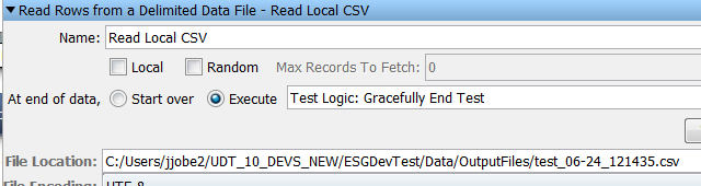

    Hi Joel, thanks for this new info. I really appreciate all the help and effort you've given to try and solve this. I tried with some different path formats, per your suggestion, but no luck.
    The path string that's set for the file and shows in the logs is below, and if i copy this into the read csv step and the file exists before executing, it works fine.
    I tried formatting the slashes as \\, but the {{LISA_RELATIVE_PROJ_ROOT}} part of the path is logged with / slash, so the formatting end up being \ and / and none of the slash formatting seemed to make a difference as i was prompted that the file didn't exist, but may be able to resolve at runtime, then same failure IO exception/unable to find file.

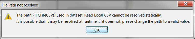

    Thanks, I tried with ) and method capitalization fixes and still get this at run time (pops up during ITR), then below error in logs (as mentioned earlier, i can copy that .csv path and load the file after it is created/before the Read Local CSV step)
    Message:     Error initializing parser
    | Trapped Exception: Error initializing CSV reader
    | Trapped Message:
    | Exception:
    | Message:     Error initializing CSV reader
    | Trapped Exception: Unable to load file: name=C:/Users/jjobe2/UDT_10_DEVS_NEW/ESGDevTest/Data/OutputFiles/test_06-23_115924.csv path:[C:/Users/jjobe2/UDT_10_DEVS_NEW/ESGDevTest/Data/OutputFiles/test_06-23_115924.csv] absolutePath:[C:\Lisa8\Lisa8\C:/Users/jjobe2/UDT_10_DEVS_NEW/ESGDevTest/Data/OutputFiles/test_06-23_115924.csv] canonicalPath:[C:\Lisa8\Lisa8\C:/Users/jjobe2/UDT_10_DEVS_NEW/ESGDevTest/Data/OutputFiles/test_06-23_115924.csv]
    | Trapped Message:   java.io.FileNotFoundException: Unable to load file: name=C:/Users/jjobe2/UDT_10_DEVS_NEW/ESGDevTest/Data/OutputFiles/test_06-23_115924.csv path:[C:/Users/jjobe2/UDT_10_DEVS_NEW/ESGDevTest/Data/OutputFiles/test_06-23_115924.csv] absolutePath:[C:\Lisa8\Lisa8\C:/Users/jjobe2/UDT_10_DEVS_NEW/ESGDevTest/Data/OutputFiles/test_06-23_115924.csv] canonicalPath:[C:\Lisa8\Lisa8\C:/Users/jjobe2/UDT_10_DEVS_NEW/ESGDevTest/Data/OutputFiles/test_06-23_115924.csv]
