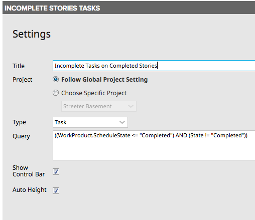

    Ah! Thanks for that clarification! In that case, I'd use a Custom List app on the Task work item type, with the following query:
    ((WorkProduct.ScheduleState <= "Completed") AND (State != "Completed"))
    0EM140000005Gpq

    Posted Aug 17, 2016 12:57 PM
    That's it James. Thank you. With a little validation this seems to be what I am needing.
