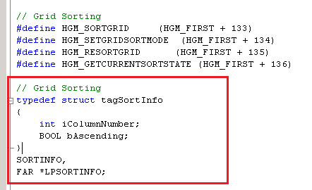

    BUT that does not mean winwidgets does not support it as in WIDGETS.H  in your CA Plex Headers folder you will see the following:
    // Grid Sorting
    #define HGM_SORTGRID (HGM_FIRST + 133)
    #define HGM_SETGRIDSORTMODE (HGM_FIRST + 134)
    #define HGM_RESORTGRID (HGM_FIRST + 135)
    #define HGM_GETCURRENTSORTSTATE (HGM_FIRST + 136)
    Now you could play with HGM_GETCURRENTSORTSTATE  as it is not clear what it does or indeed the parameters...maybe you send in the control name and column number and it sends back sorted yes no and ascending or descending or not...i don't know with out playing..it might just tell you if a particular column can be sorted ie sorting is enabled on the coloumn

  • 6.  Re: WinC: Get grid sorting columns and sort direction
    Posted May 16, 2016 04:12 PM
    When playing with HGM_GETCURRENTSORTSTATE and using the tagSortInfo structure I found it was crashing the plex runtime which to help CA support reminded me of the problem I had with the structure in C++ Client Testing Tool Support of WinWidgets Grid

    No worries my pleasure, I gave up late late last night, my hacking of c++ is not good enough. I suspect it wont work but need a c++ person to confirm. Lets hope wink wink jeremy can help jstent1.1
    // http://www.cplusplus.com/forum/windows/57382/
    typedef struct tagSortInfo
      int iColumnNumber;
      BOOL bAscending;
    SORTINFO,*LPSORTINFO;
     HWND HwndGrid=ObPanelAPI::GetControlHandleByName(&(1:));
     if (HwndGrid)
      SORTINFO *ptr_test;
      SendMessage(HwndGrid,HGM_GETCURRENTSORTSTATE,(WPARAM)ptr_test,NULL);

    I cannot find any documentation on this message.  I can get it to call the message without fouling up the calling thread.  We need CA (in the absence of the original winwidgets developers) to give us some documentation on the parameters and expected results of this windows message.  (Parameters are *Object with the grid control name, then FirstSortColumn, FirstSortSeq, SecondSortColumn, SecondSortSeq, ThirdSortColumn, and ThirdSortSeq). Columns appear to be 0 based..
         SORTINFO * sInfo;
         LRESULT lr;
         HWND hwndGrid = ObPanelAPI::GetControlHandleByName(&(1:));
         if (hwndGrid)
              lr = SendMessage(hwndGrid, HGM_GETCURRENTSORTSTATE, 0, (WPARAM) &sInfo); // changing the 0 to something else seems to have no impact
              // lr seems to be the number of sort columns.  User clicking only ever seems to set 1.  Programmatically we can set at least three.
              if (lr > 0) // at least one sort column
                   &(2:) = sInfo[0].iColumnNumber;
                   &(3:) = sInfo[0].bAscending;

    I can confirm the columns are zero based and there is only 3 possible columns that can be sorted at any one time so your guess work on the parameters are a good as we could guess.
    i spent hours last night and all i needed was '&' next to my pointer field! Dont know what & does differently just will add it to my hacks to try when writing c++ source code!

    Prefacing a variable with an ampersand ('&') gets the address of the variable.  With the address the functions that is called can modify the data, otherwise it can just reference the data passed in, and not change what is seen by the calling program.  We pass the address to the pointer to the winwidget, and it changes the value of the pointer to point to some array.  Without documentation I cannot say if we are supposed to free any memory afterwards.
    There is also a concern that someone may have clicked on a column heading, and then reloaded the grid.  In this case the grid might think it is sorted on that column, but it has really not since the data would be in the load order.  It is also possible that someone clicked on a description, and then a status.  This function call would return the status as the sort column, but would not indicate that there had been a secondary sort on the description, so if we re-applied the sort we would not sort in the same order.
