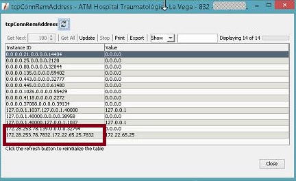

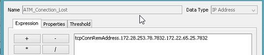

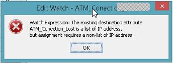

    Hi guys, I try to create a Spectrum Watch for an attribute type IP Address, this attribute is a table, so, I need evaluate just one, but when I define the expression with the form “attributename.X”  (where X, is the variable position) I have a message error “ The expression is not possible to create because the IP Address is a List and the expression is´nt) Any idea to resolve this?  The form ATTR.# (all) is not an option because this ask for all values.

    To specify an instance, you should only need to put the instance id in after the attribute name as you have noted.  I just created a watch with the following expression:
    ipNetToMediaNetAddress.4.172.19.10.10
    Threshold example would be “violated if == 172.19.10.10”
    And I get an alarm.  It sounds like you have an error in your expression. If you are literally putting .X, that doesn’t work, you have to specify the specific instance.  If it’s a variable instance that changes, watches won’t work here as watch expressions that have instances defined cannot work for variable instances that change.

    Thanks Jason, the .X just is a example, my expression is: tcpConnRemAddress.172.22.4.6.7236.167.89.23.2.6789, this value was taked from the table (tcpConnRemAddress).
    But when I put this, the watch send a message error appear. I try with the other instance and always show the same error.
    Regards
    So, where is the error or how I can put this instance..
