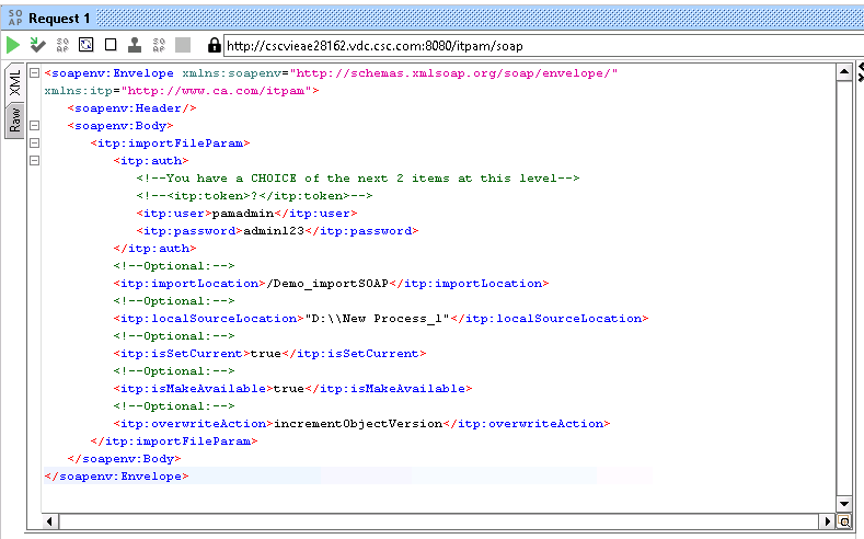

    Hi Everyone!
    I want to import a package to CA PAM using importObject() API and run by SOAPUI  like this:
    but when run it  I get a message error below:
    <SOAP-ENV:Envelope xmlns:SOAP-ENV="http://schemas.xmlsoap.org/soap/envelope/">
       <SOAP-ENV:Header/>
       <SOAP-ENV:Body>
          <SOAP-ENV:Fault>
             <faultcode>SOAP-ENV:Client</faultcode>
             <faultstring>Unable to retrieve the specified attachment.</faultstring>
          </SOAP-ENV:Fault>
       </SOAP-ENV:Body>
    </SOAP-ENV:Envelope>
    Could you give me advise in this case ?
    Thank you so much

    Hi,
    I believe your SOAP code is not the problem, the documentation seems to be a little confusing about the use of the localsourcelocation.
    From what I can tell, it does not seem to be (as one would assume at first) the path to the file on the CAPA server when using it from any other tool than the CAPA Invoke_SOAP_Method.
    I was able to get the following code to work in SoapUI by actually attaching the file as a MIME attachment, as seems to be stated in the documentation.
    If you are using the Invoke_SOAP_Method, you can set the file name in the MIME Attachment tab, otherwise I believe you will have to use platform-specific method to attach the file to the SOAP body.
    I have attached an example from SOAPui.
    Hope this helps,
    Ian
