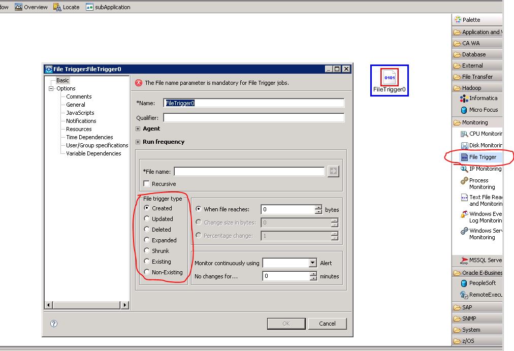

    Hi Nuno,
    Yes, it is possible.
    If you have the Desktop Client for CAWA DE, on the right-hand-side, you will find "Monitoring" under the "Palette".
    Here, you will find the "File Trigger" job type, which lets you configure a trigger based on the following file actions/statuses:
    - Create
    - Update
    - Delete
    - Expand
    - Shrunk
    - Existing
    - Non-Existing
    Hope this helps!
    Thanks,
    Avinash
