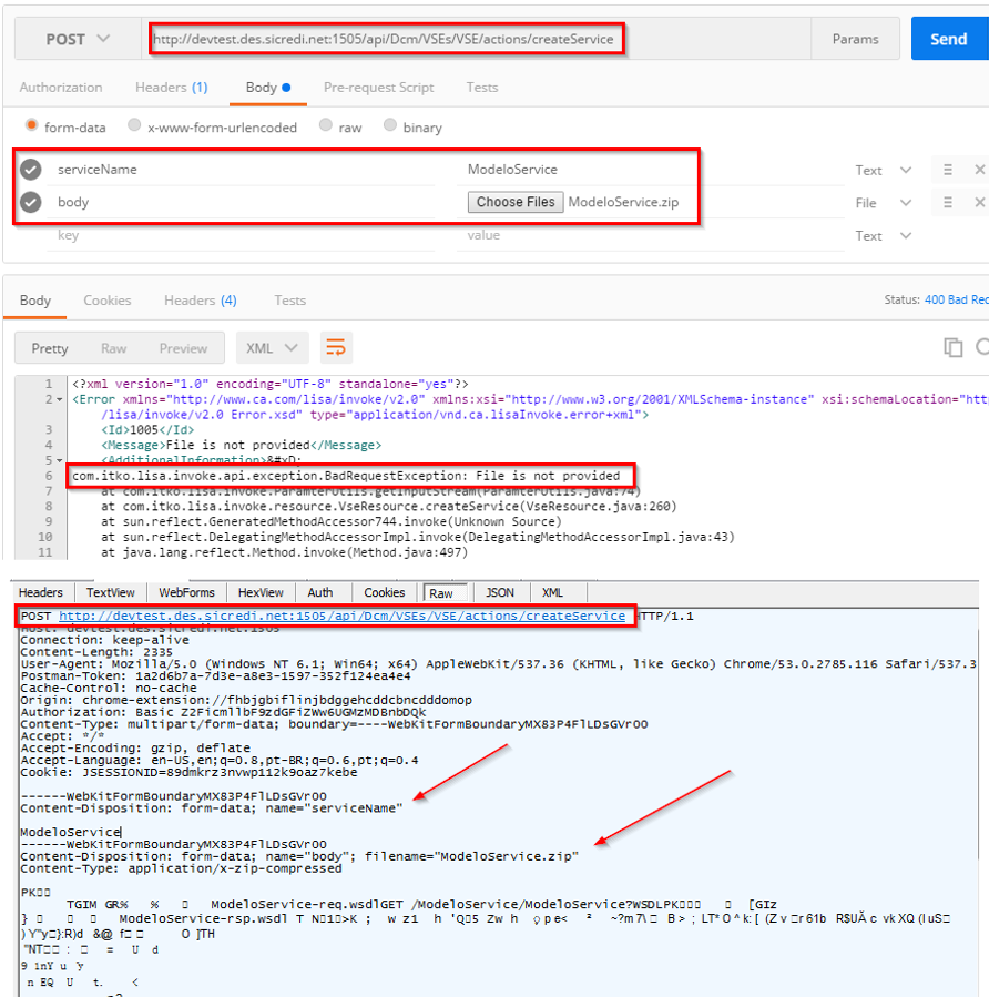

    We understood the API documentation and tried it with POSTMAN.
    Now we are getting an error like there is no file content:
            com.itko.lisa.invoke.api.exception.BadRequestException: File is not provided
    But, as you can see in the image below, the content is being sent:

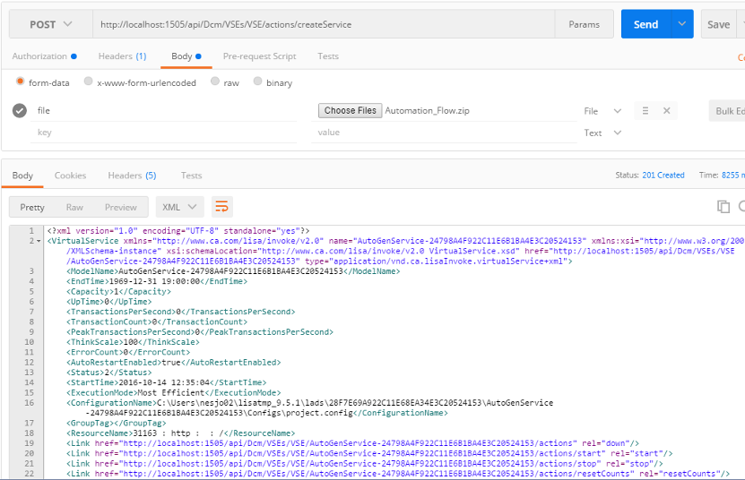

    I just used your RR pairs in a zip file and am able to invoke and create the VS.
    Here is a screenshot from Postman -
    Based on the screenshot, go ahead and give it a shot and let me know if you are not able to still generate a VS.

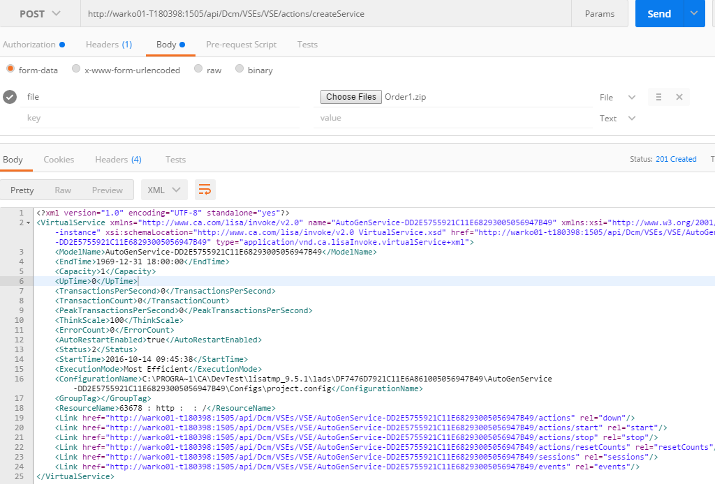

    <removed previous comment>  Updated: Koustubh was correct.  I got it to work when I switched to postman and used VSE for the serviceName.  Some of my properties file elements -- such as service name and port -- did not seem to take affect.  Will need to do some additional research.

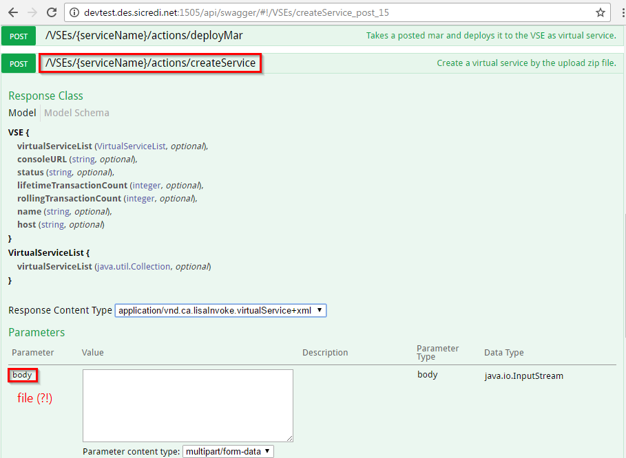

    Thank you Koustubh.Warty. I paid attention in your print screen I saw that you use 'file' instead of 'body' in your variable's name. I changed and it works.
    As you can see in the image below, it is wrong in the APIs documentation. See below.

    Hello Gabriel,
                 The body here refers to either the file or the file URI. If you look at the example shared by Koustubh, the file attachment goes into the body section of the request. Please let me know if that answers your question.
    Form Parameters
    filejava.io.InputStream
    An uploaded zip file that contains request response pairs.
    fileURIstring
    URI to a zip file. Only "file" and "http" protocol are supported.
