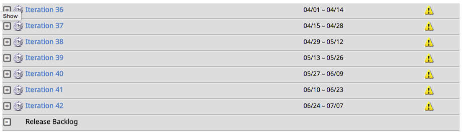

    Why is it so difficult to update, add/or change the planned velocity for an iteartion(s)? Every new quarter I see the iterations listed for that quarter with the warning icon next to them.
    0EM140000004lRj
    I then lick on every single menu item in the Plan and Track nav menus trying to figure out where the **** I need to go to change it. I eventually find it, but it's a huge waste of my time (I should create a feakin story for it since it takes me so much time, if I ever figure out my velocity searching for this has already impacted it!!).
    I try clicking on the warning icon (that seems like it would make sense don't you think), but it does nothing. Yes, it's true in the past I've been able to figure it out, but as of now I haven't been able to for this quarter so far... and why should I have to waste so much time looking anyway? Short term memory is a *****, it needs to be accounted for on features that are rarely utilized, but do come into play eveyr so often. I should have to relearn how to do it every time it comes up.
    A) Please make this easier in the future
    B) Where the F do I go to update/change it?!

    Hi Justin, thanks for the feedback -- we really do appreciate it!  We've actually been working on making this easier, and have recently released the new Timeboxes page.  The Timeboxes page brings together Iterations, Releases, and Milestones under one roof!
    The Timeboxes page makes it really easy to update the Planned Velocity for an Iteration.
    1.  Go to Plan --> Timeboxes
    2.  Make sure Iterations is selected in the dropdown
    3.  Click in the Planned Velocity column to edit the value
    4.  Enter a value and hit Enter or click away from the column
    5.  Done!
    Here's me doing it after seeing that error icon in Plan -> Plan: Adding Planned Velocity

    Thanks for the reply and it was a nice touch to allow users to update the velocity inline, hit enter and then jump to the next line so if I start from the top of the list I can quickly enter velocities for all of the upcoming iterations so I shouldn't have to worry about this again for a while!
