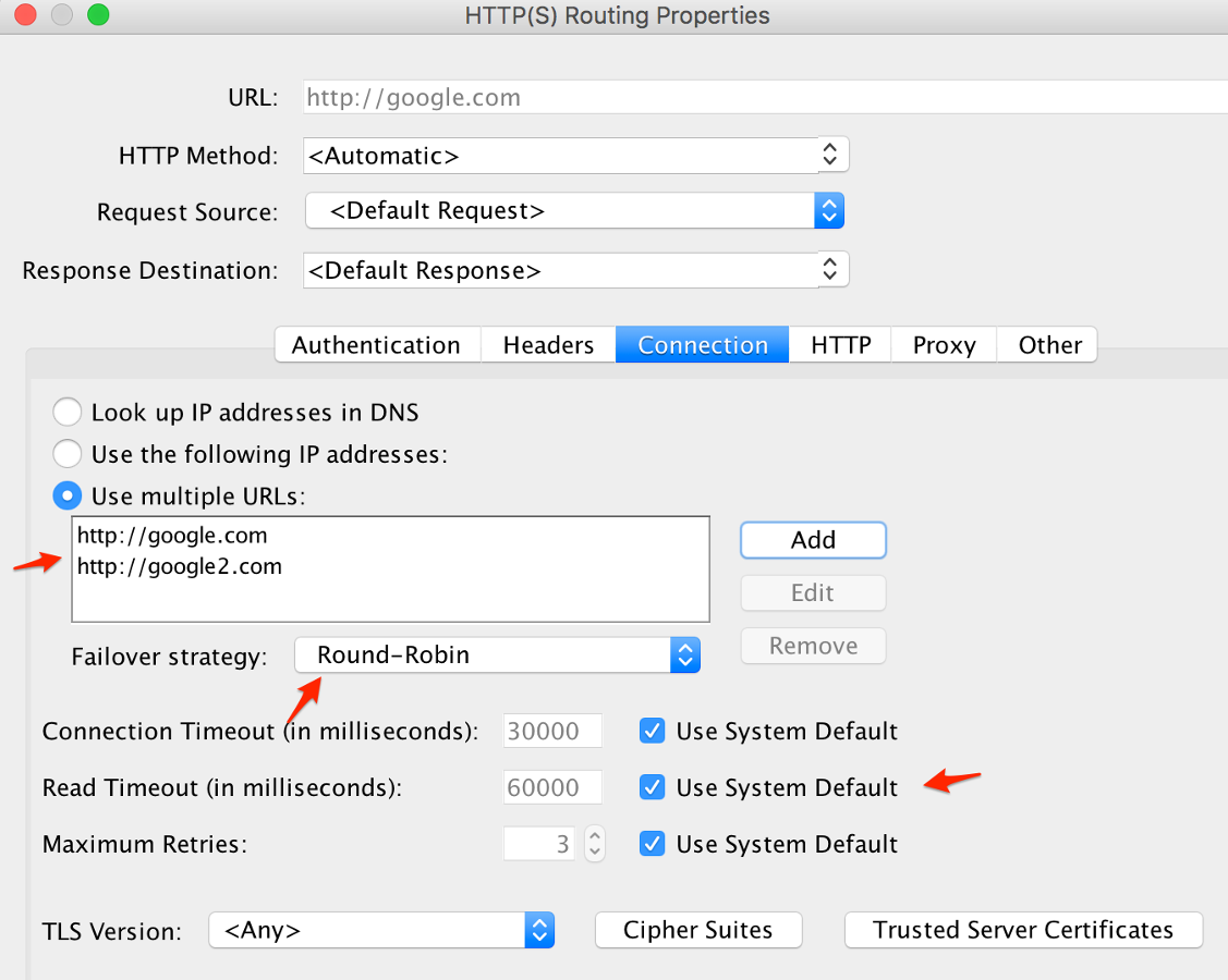

    Hey Sam,
    You should be able to do this in the Route via HTTP Assertion itself.
    Here's an example of what a route could look like
    it this case, we have multiple urls to route to and we are using a 'Round-Robin' failover strategy...

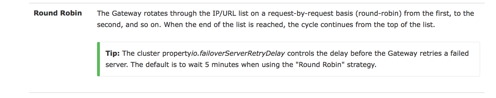

    looking at the doc, here are the details of 'Round-Robin'
    hope this helps!
  • 5.  Re: API Gateway load balancing across servers
    Posted 10-12-2016 03:42 PM
    Thank You , Sir. Much appreciated. Will test and let you know.
    I have been playing with that assertion for a couple of days but could not find that screen,
