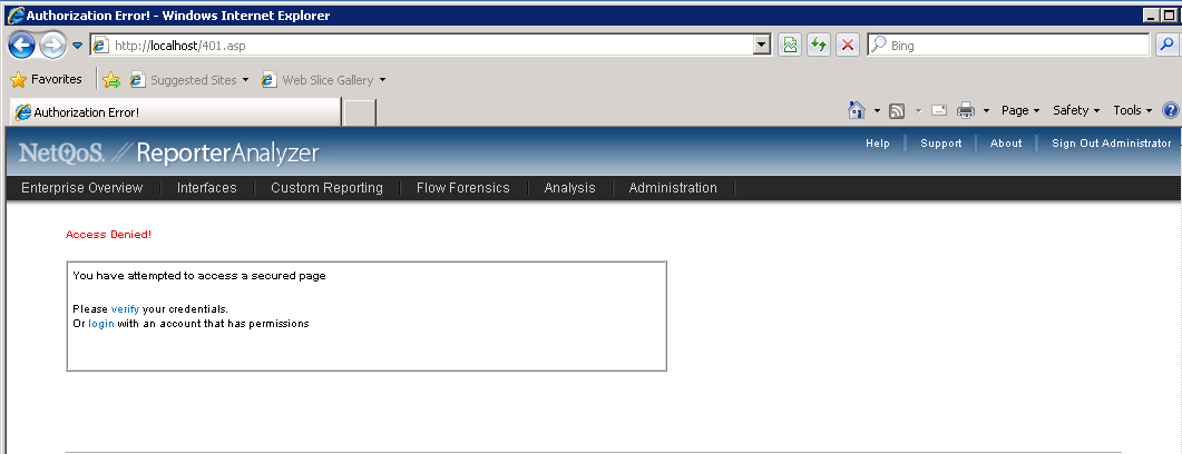

  • 7.  Re: HTTP Error 500.19 - Internal Server Error
    Posted Jun 15, 2015 05:28 AM
    Hi Chris,
    IUSR is part of Administrators group, I made sure I added it. When I access the web interface I get directed to a list of the attached links(login error1) as the first error
    The first link on the attachment redirect me to the RA portal page that shows Access Denied, and it seems as if it logs in as "administrator" account without prompting me to login, see login error2 attached,
    Not sure what could be changed to make this right as I have went through the install tips on community plus installation guide.

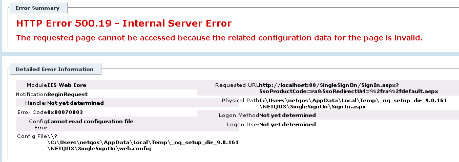

  • 9.  Re: HTTP Error 500.19 - Internal Server Error
    Posted Jun 17, 2015 03:58 AM
    Morning Chris,
    I have followed the knowledgebase article and found that the default.aspx exist already, also moved it up the list to improve performance. I now get the below  error when I use http://localhost/ra/default.aspx:
    I tried searching for that web.config file, but can't find it anywhere, and RA is installed under C:\NETQOS....
    NPC is not installed yet, should I I go ahead install NPC to resolve this?
    Thanks in advance.
    Morongwa
  • 10.  Re: HTTP Error 500.19 - Internal Server Error
    Broadcom Employee
    Posted Jun 17, 2015 08:32 AM
    Installing NPC will not fix this.
    Also if you will be upgrading to NFA 9.3.x you will need to have NPC on a separate server anyway.
    That path seems strange, maybe it was leftover from a reinstall of RA.
    Check the Default Web Site's physical path, as well as the other web site directories in IIS.
    It looks like this error is looking for the SingleSignOn directory, so check that site to make sure its pointing to your SSO directory.

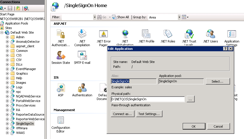

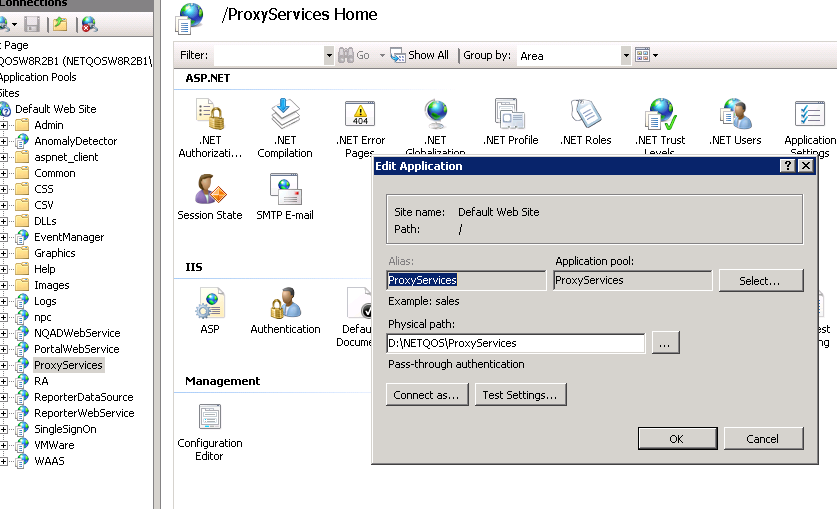

  • 13.  Re: HTTP Error 500.19 - Internal Server Error
    Broadcom Employee
    Posted Jun 17, 2015 10:30 AM

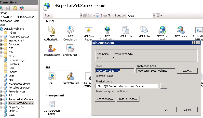

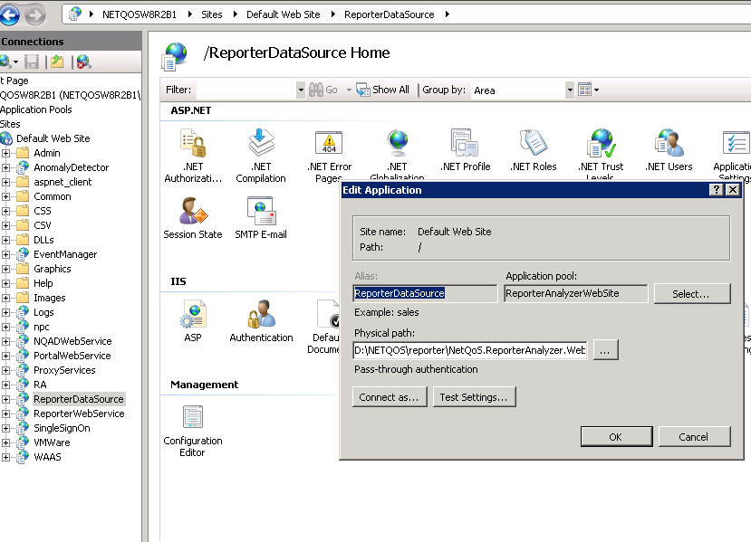

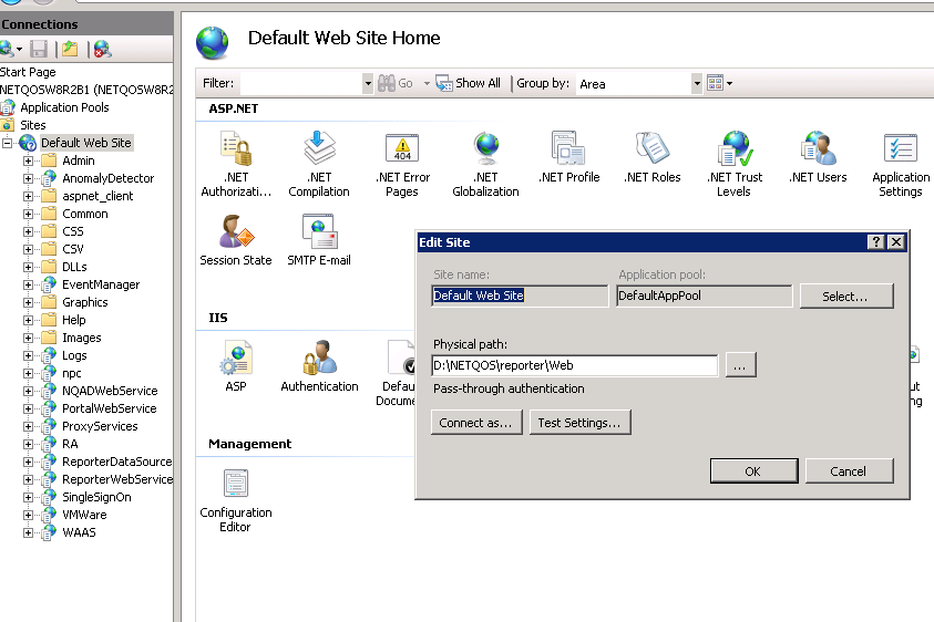

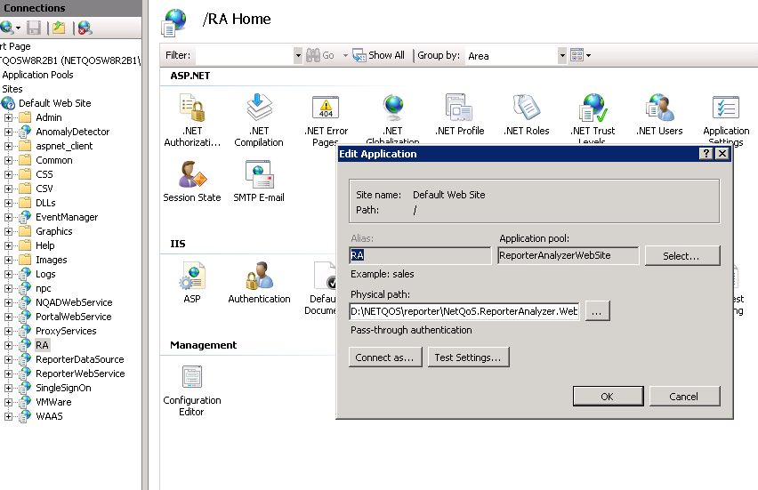

    Here are the path's from my 9.0 lab....

    I had a look at all the settings, I am missing SingleSignOn directory in my lab server and that is probably the issue here. Seems like the installation did not put SingleSignOn packages on the server during the installation, I might have to copy the files from my client's production server over to my lab server. Will that work? My client is on Win2003 and my lab is Win2008.
    Thanks and regards.

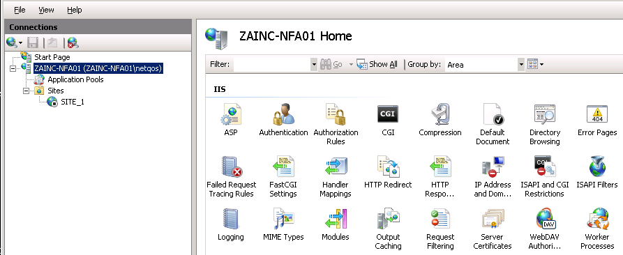

  • 19.  Re: HTTP Error 500.19 - Internal Server Error
    Posted Jul 07, 2015 08:14 AM
    Thanks Chris,
    I have just re-installed today.
    SSO files were installed this time under C:\NETQOS\ directory. I tried logging in, now I get the page cannot be displayed. Apon my investigations, I noticed I am missing Default Web Sites from IIS Manager.
    Strange one
    Regards
    Morongwa
