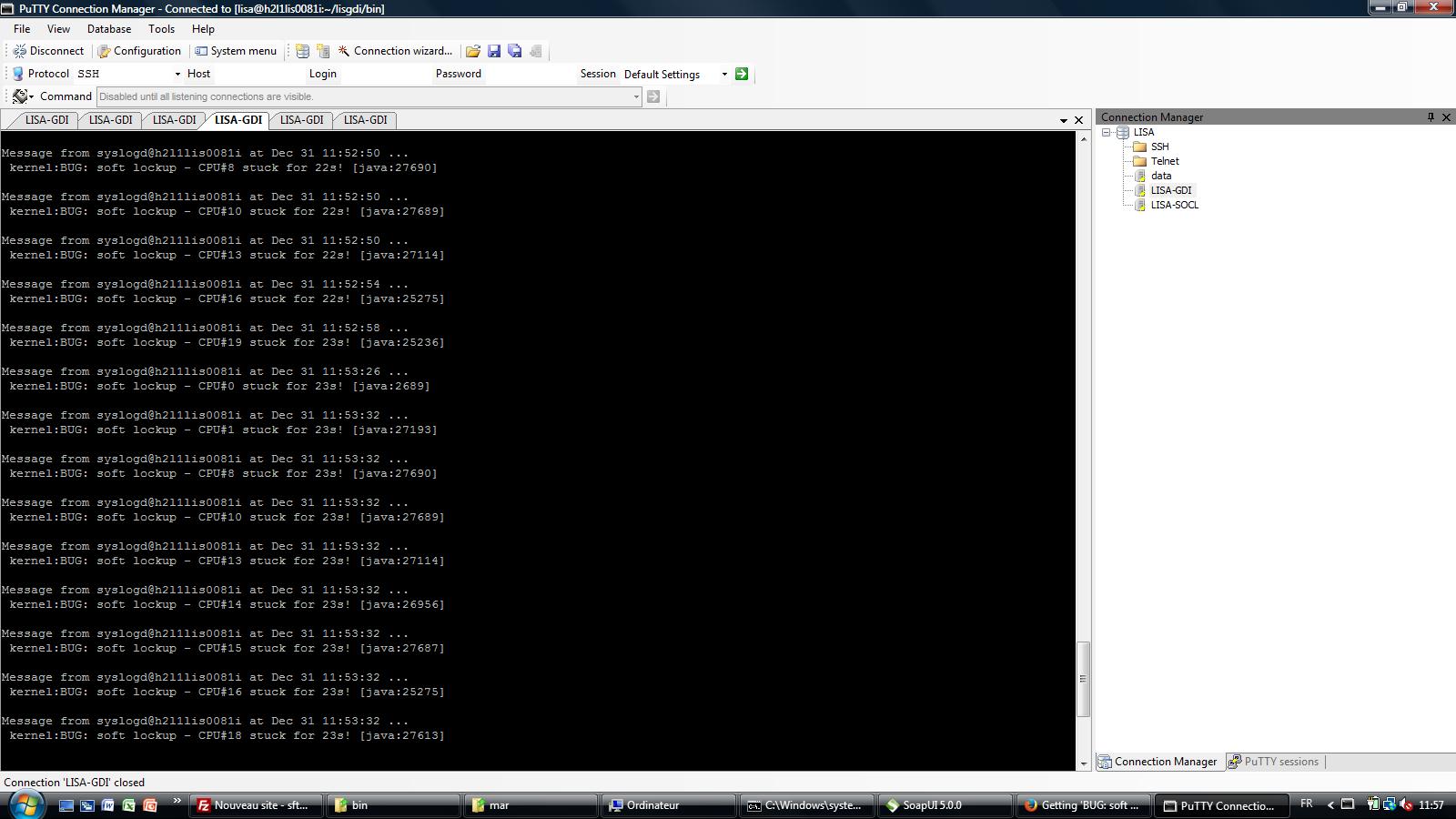

    I used to install LISA devtest 9.0 on Linux Ubuntu, Java 7. I have just started to pass to Linux Redhat 7.1 and Java 8 and I have this bug:
    kernel:BUG: soft lockup - CPU#19 stuck for 23s! [java:25236]
    java:25236 is a LISA process (as the picture below)
    My server stopped running right after
    I would like to know if this problem comes from a LISA bug. FYI, our server has 20 CPUs and 32Gb RAM. Our network administrator told that the bug can't come from OS or Hardware...

    I used to see this error quite often in Linux, when the power supply wasn't rated high enough for the load that the CPUs were drawing when being exercised hard.
    This is just a guess, but can you ask your administrator if that machine provides the ability to monitor its voltages? I would tend to look there first. I see from your post that it's running in a VMWare session. Are there lots of VMWare sessions running on that hardware, causing IO delays?

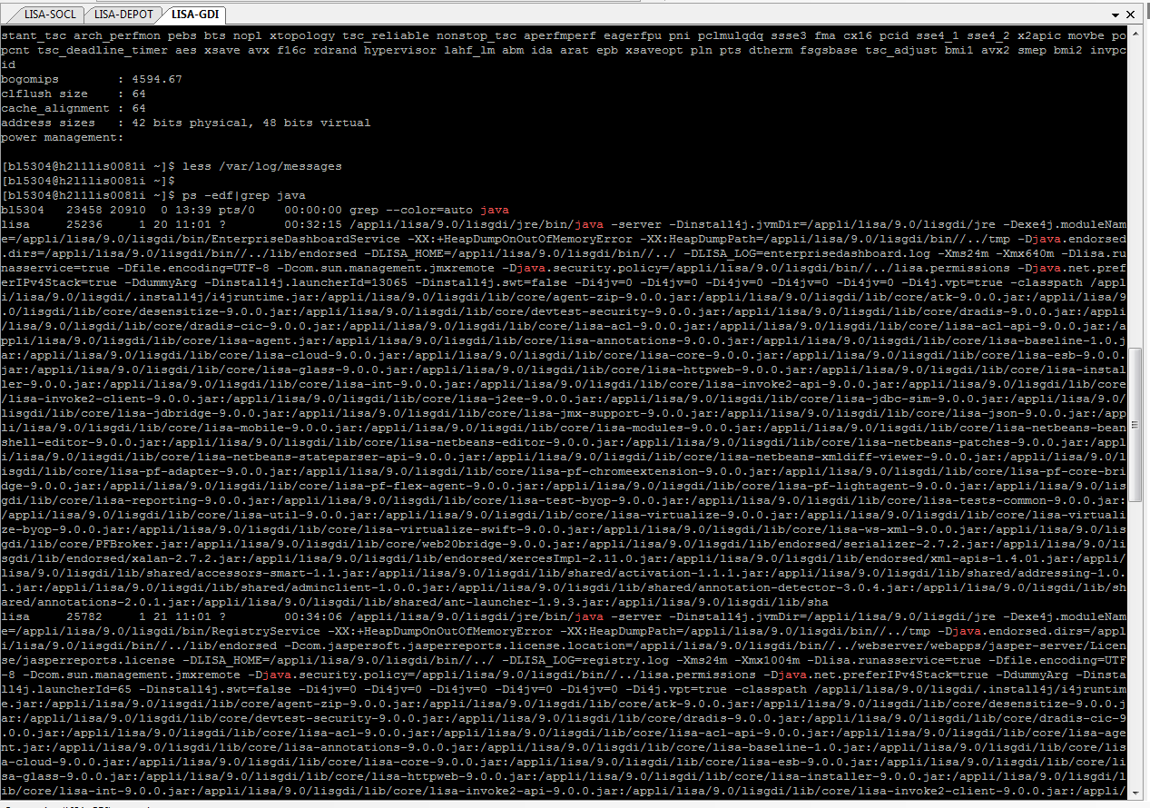

    Your second screenshot shows every CPU in a stuck mode, with different Java process IDs. Is DevTest running on each of these? If so, your administrator might want to install cpulimit to restrict the number of CPUs that DevTest can use (equivalent to "set affinity" on Windows), or nice them to a lower priority.
