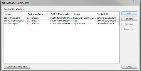

- You first need to import a public key, i.e. certificate of your backend destination into the gateway's trust store. You then need to export your gateway's certificate into your backend destination trust store.
- To import cert:

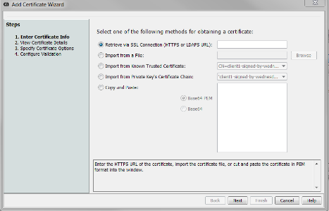

- Go to Tasks > Manage Certificates
- Click Add on the right
- Add via file, or via http connection

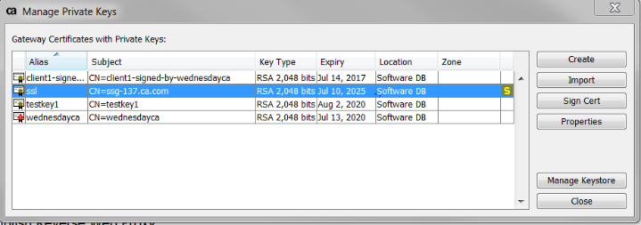

- Go to Tasks > Manage Private Keys
- Click on the Private Key called "ssl" and click Properties on the right

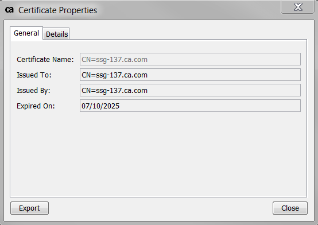

- Then click View Certificate
- Then Click Export

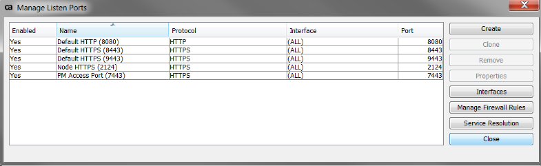

- Go to Tasks > Manage Listen Ports

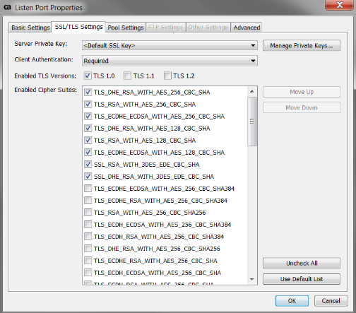

- Click on the Default HTTPS (9443) and click Properties on the right
- Go the the SSL/TLS Setting tab and make sure Client Authentication dropdown says Required.

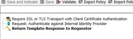

4. In policy, drag the "Require SSL or TLS Transport with Client Authentication" assertion. Make sure when calling this policy/endpoint you are using the port that requires client auth. Below it, drag in an "Authenticate against Internal Identity Provider" assertion, or could use Auth against User or Group and specify the certificate user.
