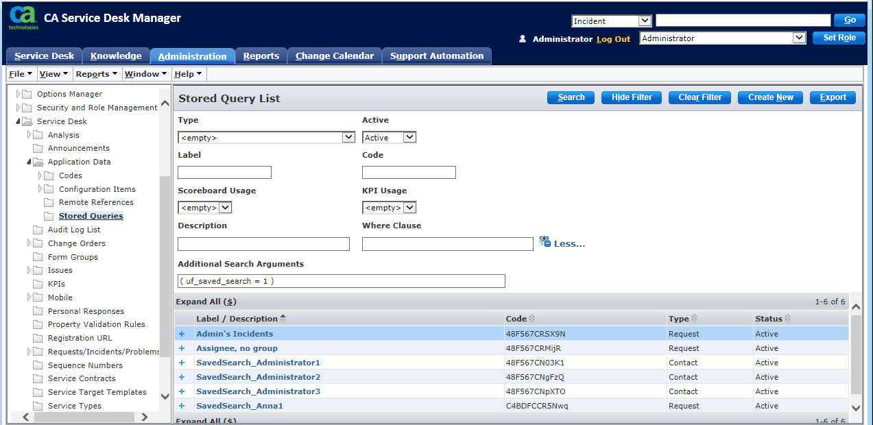

    I had a look at the data stored in the Cr_Stored_Queries (crsq) and User_Query (usq) tables when a Saved Search is done.
    It looks like the field in Cr_Stored Queries called "uf_saved_search" is set to "1" when a user creates a Saved Search.
    It's an undocumented field, so I have no idea if this is the only thing that it does, but the following query seems to return all Saved Searches. Please try it out and let us know.
    From the "Stored Query List" under Administration, Service Desk, Application Data, Stored queries, enter the following Additional Search Argument:
    • uf_saved_search = 1
    Or if you wish to extract these from a command prompt:
    • pdm_extract -f "select * from Cr_Stored_Queries where uf_saved_search ='1'"
    Note: Run these with Administrator access, as the web client and pdm_extract obey security. Otherwise you'll only see what you are restricted to.

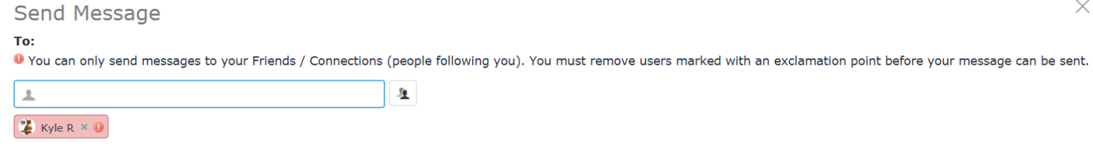

    Posted Jul 14, 2016 07:00 AM
    Hi Kyle,
    I can't seem to message you since you're not following me....
  • 14.  Re: New Saved Searches functionality in 14.1
    Posted Jul 15, 2016 02:44 AM
    Hi Tammy,
    Not sure why you can't message me - I thought this was opened up to avoid using that restriction. I'll check into that. In the meantime, I've Followed you.
    The CA Support engineer also spotted this thread and provided me with the case number. I haven't had a chance to get a good look at it yet, but I'll be available as needed. It seems to be performance orientated.  If you're not seeing long running queries in the stdlogs related to the Stored Queries used by the Saved Searches, I'd say the problem lies elsewhere.

    • The Node name is user determined. It starts as the same as the Cr_Stored_Queries  "label" but may be user edited.
    Example:
    A User finds or locates a Stored Query.
    Either:
    • A user performs a "Saved Search" and creates a Stored Query called "SavedSearch_Administrator1".
    Or:
    • A user creates a Stored Query called "SavedSearch_Administrator1".
    Or:
    • This Stored Query is created by another, and they find it.
    Or:
    • The Stored Query is created by another and they get it from a Role.
    They then:
    • Edit their User Scoreboard to change the Node name to "SavedSearch_Administrator1_EDITED".
    This generates the following Table entries:
    TABLE Cr_Stored_Queries
    code count_url criteria crsq_owner del description id label last_mod_by last_mod_dt obj_type persid tenant uf_saved_search usage_flag
    { "48F567CN03K1" ,"", "delete_flag = 0 AND last_name LIKE \\0134'Con%\\0134'", "48F567C80F28EB4BA91567D03B4AFEE2" ,"0" ,"SavedSearch_Administrator1", "400053" ,"SavedSearch_Administrator1" ,"48F567C80F28EB4BA91567D03B4AFEE2", "07/15/2016 13:59:02" ,"cnt" ,"crsq:400053" ,"" ,"1" ,"0" }
    TABLE User_Query
    expanded factory id label last_mod_by last_mod_dt obj_persid parent persid query query_set query_type role_persid sequence tenant
    { "0" ,"cnt" ,"401790" ,"SavedSearch_Administrator1_EDITED", "48F567C80F28EB4BA91567D03B4AFEE2" ,"07/15/2016 14:23:10", "cnt:48F567C80F28EB4BA91567D03B4AFEE2" ,"401679" ,"usq:401790", "48F567CN03K1" ,"0" ,"0" ,"role:10002" ,"62" ,"" }
    The Cr_Stored_Queries Table (crsq) field "code" links to the User_Query Table (usq) field "query."
    Key Points regarding Active vs Inactive
    • Only Stored Queries can be made Active or Inactive.
    • Nodes on the Scoreboard are either there, or not. They don't care whether the Scoreboard Query is Active or Inactive. They don't even have an Active flag.
    • Making a Stored Query Inactive PREVENTS it from being ADDED to the Scoreboard, but it does NOT DISABLE EXISTING Scoreboard Nodes from working.
    To repeat, making a Stored Query Inactive will prevent people from adding it to their Scoreboard. But it won't take away that Node from anyone who has it on their Scoreboard already.
    Impact of the New Saved Search Functionality
    Good or bad, this has been how the Scoreboard/Stored Query functionality has behaved since the beginning.
    The new "Saved Search" functionality did not change the basic Scoreboard/Stored Query behaviour.
    What it did do is to more easily allow Users to create and save their own Stored Queries and attach them to their personal Scoreboard.
    They have always been able to do this (if permitted), but would previously have needed to write the Queries under the Administration tab.
    So it is fair to say that access has been opened up.
    I agree that it is a reasonable request that some additional Role or Access Type restrictions around this would be a good Idea to log. Rather than the "all or nothing" affair of the DISABLE_SAVED_SEARCHES variable.
    Tammy's Idea is here. Please vote on this:
    Disabling new 14.4 'saved search' functionality and deactivate existing saved searches
    You can find other Scoreboard Ideas here.
    Examples:
    Make access to "Saved Searches" depend on Role/Access Type security, in SDM
    Inactive Scoreboards
    Force\Push\Insert Scoreboard Query
    How to Remove a Stored Query from a User Scoreboard
    Aside from Resetting the Tree or pushing out the Role Scoreboard again, or simply asking the user to remove the Node, an Administrator has the following backend options.
    • Edit the existing Node and replace it either with a harmless query and/or a change to the Node Name such as "Node invalid - please see Administrator."
    • Remove the whole Node completely.
    As both processes are similar, I'll give just one set of steps.
    CAUTION: This process involves direct database manipulation and can be destructive if care is not taken.
    NOTE: The pdm_extract/pdm_load scenario is cross platform.
    You may instead modify the  commands to work directly in the database if you wish.
    Steps.
    1) Identify the Stored Query which is the source of the problem.
    See Example: How to identify who ran a poor performance query above in this thread.
    The key item that you will need is the Cr_Stored_Queries Table (crsq) field "code".
    The following extract shows both the code and the label.
    pdm_extract -f "select code, label from Cr_Stored_Queries where code = '48F567CN03K1'"
            code label
            { "48F567CN03K1" ,"SavedSearch_Administrator1" }
    Cr_Stored_Queries
            rows:1
    Note: Instead of "where code" you may use "where label" if that is known instead. Eg:
    pdm_extract -f "select code, label from Cr_Stored_Queries where label = 'SavedSearch_Administrator1'"
    Note: If you are only interested in "Saved Searches", then remember that the Cr_Stored_Queries field of uf_saved_search = 1 for these.
    2) Identify all Scoreboard Nodes that have this Stored Query and so need to be removed/edited.
    In this example, it is just one user. To easily check that it is the right information, just a few fields can be extracted:
    pdm_extract -f "Select query, label, persid, last_mod_by from User_Query where query  = '48F567CN03K1'"
    TABLE User_Query
            query label persid last_mod_by
            { "48F567CN03K1" ,"SavedSearch_Administrator1_EDITED" ,"usq:401790", "48F567C80F28EB4BA91567D03B4AFEE2" }
    User_Query
            rows:1
    But if you want to Delete/Edit in Step (3), then also take all fields like so:
    pdm_extract -f "Select * from User_Query where query  = '48F567CN03K1'" > usq_48F567CN03K1.txt
    3a) Edit. If you want to leave the Node on the User's Scoreboard with a message.
    • Modify the file. Save it to a copy  eg. usq_48F567CN03K1_MOD.txt
    • Change the "label" eg ""Node inactivated - please see Administrator."
    • Point the "query" to a known harmless query. For example, one which can only have zero results. Or one that points to a Closed Incident which documents more information about why the Node was made Inactive.
    • Load the file:
      pdm_load -v -f usq_48F567CN03K1_MOD.txt
    • Send the user an email to advise of the change.
    3b) Remove. If you want the Node gone from the User's Scoreboard.
    • Load the file with the "-r" option to "remove" it.
    pdm_load -v -r -f usq_48F567CN03K1.txt
    command = C:\PROGRA~2/CA/SERVIC~1\bin\dbload -v -r  usq_48F567CN03K1.txt
    Processing usq_48F567CN03K1.txt
    . <snip>
    User_Query :
    Rows   :1
    Inserts:0
    Updates:0
    Errors :0
    MaxKey :401790
    Ending Totals:
    Total tables :1
    Total rows   :1
    Total inserts:0
    Total updates:0
    Total errors :0
    Highest Table keys processed     :User_Query(401790)
    Files processed: 1
    NOTE: The user may need to log out and in of Service Desk Manager for the changes to take effect.
    Any issues with the pdm_extract or pdm_load will write to the /log/stdlog when the "-v" switch is used.
    I hope that this helps everyone to administer the Scoreboard to edit or remove unwanted Scoreboard queries.
    Thanks, Kyle_R.
