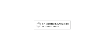

  • 1.  WCC login stuck on Loading User Interface...
    Posted Jun 16, 2015 08:39 AM
    After patching AutoSys to 11.3.6.SP1 and applying the attendant required WCC patch, I cannot connect to WCC on 2 different browsers (IE8/FF38) on my PC, can connect on a different browser on a different machine (IE10), and cannot connect on yet another machine (IE8).  One colleague gets the same fault on his PC (IE?), while another has no issue on her PC (IE10).
    We do have a ticket open, but meanwhile, this does seem like a browser cache issue, or something.
    Have tried:
    • Rebooting PC
    • Clearing browser cache, history, cookies, etc.
    • Rebooting WCC server (had to for SP1 patch anyway, but twice now).
    Head scratching time.  What else can we look at?

    On the PC you’re still able to access, does it work after clearing cache? Maybe the patch didn’t go in well and your PC picked up the latest while the still-working PC is holding on to the good version. Please validate the fix using patchtool VERIFY.
  • 10.  Re: WCC login stuck on Loading User Interface...
    Posted Jun 16, 2015 10:14 AM
    The RO80613 patch went in, but not cleanly, it appears.  The install log didn't complain at the end (only in the middle).
    2015-06-10 15:33:28 Error copying 2_6.cache.js to []\tomcat\webapps\wcc\launcher\deferredjs\[].cache.js: No such file or directory
    2015-06-10 15:33:28 CA-wcc-services Service starting
    2015-06-10 15:33:31 CA-wcc-services Service started
    2015-06-10 15:33:31 CA-wcc Service starting
    2015-06-10 15:33:36 CA-wcc Service started
    2015-06-10 15:33:36 Total copied files: 105
    2015-06-10 15:33:36 Total backed up files: 86
    2015-06-10 15:33:36 Total deleted files: 86
    2015-06-10 15:33:36 WCCPatchTool:  Complete.
    2015-06-10 15:33:36 The logs have been saved in []patches\logs\WCCPatchTool_20150610_153230_RO80613_INSTALL.log.
    2015-06-16 09:47:19 RO80613 patch has not been installed correctly.
    2015-06-16 09:47:19 Number of files that may not be installed correctly based on filesize = 17
    Back to the CA ticket queue.  Thanks all.

  • 13.  Re: WCC login stuck on Loading User Interface...
    Best Answer
    Posted Jun 19, 2015 09:42 AM
    CA provided a modified patch RO806013 that worked.
    The original version had problems, but exited without complaint.  That's a bug.
    The verify patch command did complain about the first version not being installed completely.  We'll add this step to every future patch.
