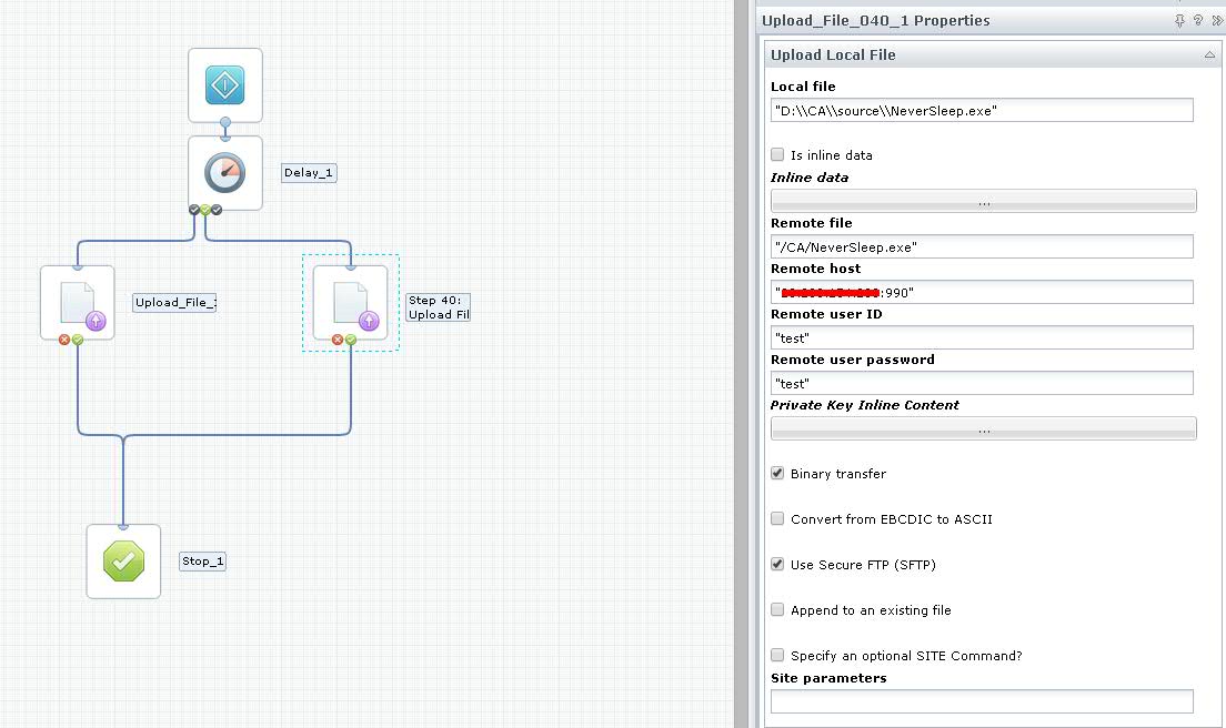

    I have a problem while using the upload file operator with use SFTP (PAM version 4.2 SP02).
    (If I use upload file without SFTP, it's OK)
    Please help me if you have any way to do that.
    And this is error: Failed to connect to  the ssh host due to exception "The connection did not complete"

    I found out the root cause: The issue at FTP server.
    When I re-install FTP server and config it, It's work well.
