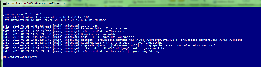

    Here is a small test with a parsed xml var.

        <gel:set asString="true" select="$xogReadProjects/Envelope/Body/ReadProject/NikuDataBus/text()" var="ReceivedDate"/>
        <gel:log>ReceivedDate = ${ReceivedDate}</gel:log>
        <core:set var="ssReceivedDate" value="${ReceivedDate.substring(0,10)}" />
        <gel:log>ssReceivedDate = ${ssReceivedDate}</gel:log>
        <gel:log>Dump Context Variables</gel:log>
        <core:set var="entries" value="${context.getVariables().entrySet().toArray()}" />
        <core:forEach var="entry" items="${entries}">
            <core:if test="${!entry.getKey().equalsIgnoreCase('systemScope')}" >
                <gel:log> ${entry.getKey()} = ${entry.getValue()} |  ${entry.getValue().getClass().getName()} </gel:log>
            </core:if>
        </core:forEach>
    </gel:script>
    V/r,
    Gene
