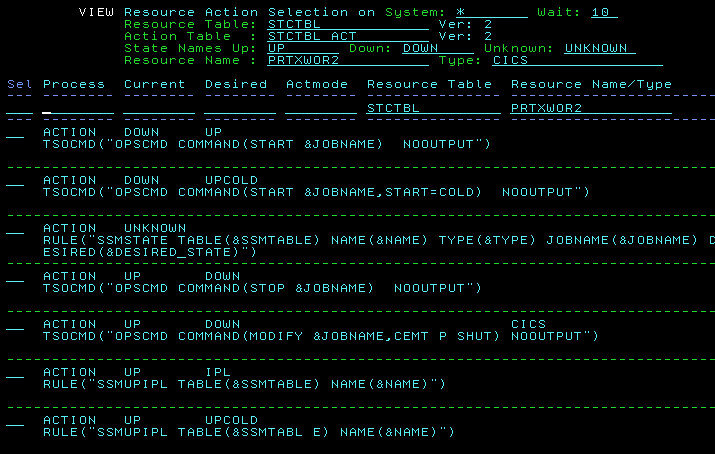

    This is the Resource table, with defined actions.

    5. The resource did not terminate. And OPS/MVS tracked them in this state:
    6. Then later for the IPL shutdown.
    [This is what I think OPS/MVS decided, and I'd like to know if that is a correct deduction on my part.]
        As the resource was already DESIRED state DOWN, and the UP_DOWN action had already triggered, (OPS/MVS keeps record of this?) OPS/MVS couldn't perform any more action against the resource, and selected UNKNOWN.
    Regards,
    Mark Noonan
