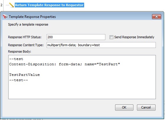

    I want to be able to return a basic MIME multipart response using the "Return Template Response to Requestor" assertion. The following picture is what I have:
    This is what I am getting back from the gateway:
    I am thinking I somehow have the wrong syntax in the Response Body. Does anyone know how to make this actually return a MIME multipart response?

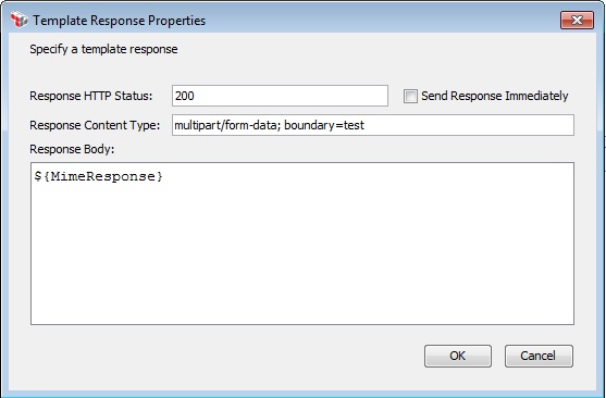

    I figured this out on my own today. The answer is to use a context variable for the parts, then feed the context var to the Response Body. The screenshots below show this:
    Using the context var above, the gateway now responds with what I want:
    I am thinking the "Save Line Breaks as: CRLF" was the culprit here. The Response Body in the GUI is not using CRLF at the end of it's lines.
