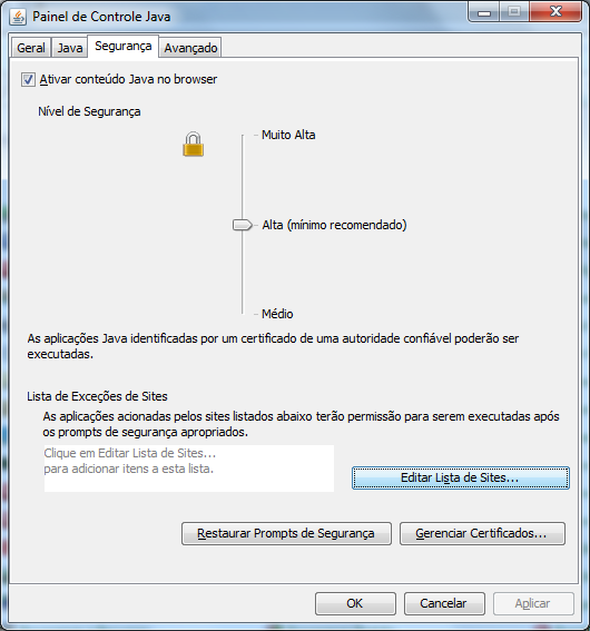

        <jar href="lib/contrib/clientcivpn
  • 8.  Re: Important: Problems to Certificates on your CA Spectrum One Click Installs – Please Read
    Posted Feb 25, 2015 10:02 AM
    Hi Dan,
    Have you tried adding the Spectrum OneClick server address to the exception list? Then there is  no need to change the security levels
    Regards,
    Dencel

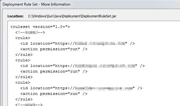

    The problem with the workaround will be that most users - for security reasons - don't have the rights/ permission on their computers to change Java related settings (or other settings).
    The Java settings on the Client PCs are configured via Group Policies and these Group Policies are company wide and have to match the company's Security Policy. I think it will be difficult to lower the Java security settings only for the group of Spectrum OneClick users and even more difficult to push through that the Java settings are changed for all users in the company.
    Especially with the latest news in mind that big companies are more and more attacked by hackers, lowering security settings is a no-go for most of our customers.

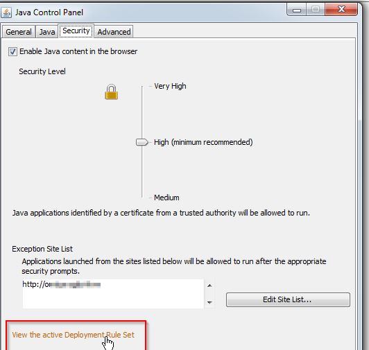

    Is there a way for us to reproduce this issue ahead of March 1?
    I would like to see it break when set to High/Very High, and then work when set to Medium -- just to validate the workaround.
  • 25.  Re: Important: Problems to Certificates on your CA Spectrum One Click Installs – Please Read
    Broadcom Employee
    Posted Feb 25, 2015 02:51 PM
    Yes, you can change the system clock on the client box to a date after March 1st.
    The recommended workaround will be to use the exception list over changing the security setting.  You may want to try them both.

    Changing security settings or updating Exceptions list will not work for many users .
    This is not just due PC admin rights but also to new JRE security restrictions, that will simply ignore those settings.

    An additional problem that you may run into in trying to use the Exception List is if your site uses Deployment Rule sets. This is a JAR file, typically in C:\Windows\Sun|Java\Deployment\DeploymentRuleSet.jar which is distributed within an organization. If your Java control panel has "View the active Deployment Rule Set" as shown, you're one of the affected ones. The problem is (as Oracle states), that anything added to the Exception Site List is ignored.
    https://www.java.com/en/download/faq/exception_sitelist.xml
    Deployment Rule Set
    If an active deployment rule set is installed on the system, the deployment rules take
    precedence over the exception site list
    . The exception site list is
    considered only when the default rule applies. See Deployment
    Rule Set
    for more information about deployment rules.

    Posted Mar 02, 2015 09:42 AM
    Yes, a colleague of mine who did not change the Java security level to Medium, got the problem this morning.
    We did not install the patch, but things went well for those of us who either let the session open or changed the java security level.
    We are running 9.3 (9.3.0.2.91)

    Hi Kiran,
    No, my security level is set to "High", in portuguese "Alta" and OC client has to be closed frequently by a huge number of operators.
    Tks,
