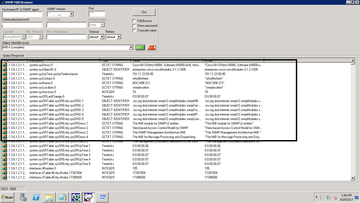

  • 6.  Re: How to discover Network Devices on CA UIM
    Posted Sep 25, 2017 05:33 AM
    If you dont mind can you share screen shots , am using uim 8.5.1 , am able to see required mibs under mibs browser . but how to add it the agent created on snmp get.  agent
