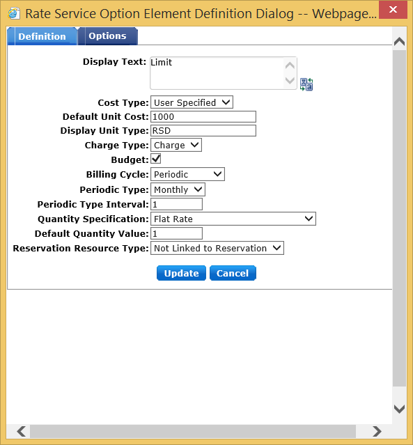

    I have created a service options that have cost rate defined as on picture
    on preview everything is working fine and also on all profile except the end user and catalog user profiles.
    On this two profiles only display text is shown for this option. Default cost is not shown and you can edit that value like on other profiles.
    No security has been set for this offering and nothing should block this from showing.
    Can anybody give me the hint what could be a problem?

    I have found solution in the meantime.
    in the following option you can define what role could see the cost value like the one I mentioned in the question
    Catalog > Configuration > Access Control: Show Amount Column and the roles
