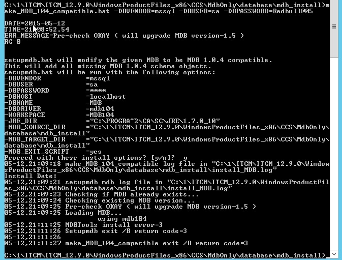

I was trying install ITCM in WIN 2012 and i got this error:
Looking for a install_mdb file
c:\users\administrator\appdata\local\temp\itrm\database\mdb_install\install_mdb\install_mdb.log i can see
MDBTools_0309E - DBDriver failed to install!
MDBTools_0104I -
MDBTools install error=3
make_MDB_104_compatible exit
Other post about
MDB Install error on Windows server 2012
Maybe a Solution
https://support.ca.com/cadocs/0/j028041e.pdf?intcmp=searchresultclick&resultnum=12
To install the CA MDB r1.0.4 compatibility patch for SQL server

Look for a installation midia
e:\WindowsProductFiles_x86\CCS\MdbOnly\database\mdb_install\make_MDB_104_compatible.bat
How do fix this error?
Or
How can i find real error?
