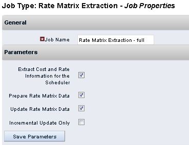

    2. The full run:
    Rate Matrix Extraction (full) which runs with options:
    -Extract Cost for Schedulers (if needed)
    -Prepare Matrix Data
    -Update Matrix Data
    Run nightly at least once.
    Do not run the full run duing Production hours.
    This job must complete before an instance of the Post Timesheets job run.
    The job provides rates to the Post Timesheets job and baseline actions.

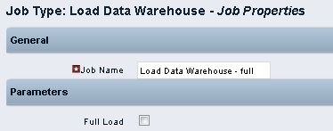

    1. Run incrementally (without the "full load"parameter) at key times during work day.
    2. Run with the "Full load" parameter nightly.

    NOTE 3:
    The full Rate Matrix Extraction job must complete before the Post Timesheets job runs.
    To enforce this best practice, set the Rate Matrix Extraction job as incompatible with the Post Timesheets job.
  • 11.  Re: Clarity Tuesday Tip: How should the main Clarity jobs be scheduled?

    The Post Timesheets (PT) job obtains the rate from the
    a. NBI_PROJ_RES_AND_RATES_AND_COSTSCP, which is populated when the RME parameter "Prepare Matrix Data" is selected.
    b. NBI_PROJ_RES_AND_RATES_AND_COSTS, which is populated when the RME parameter "Update Matrix Data" is selected.
    The Post Transactions to Financials (PTF) job obtains the rate from the live matrix,
    which is found in PPA_MATRIX/PPA_MATRIXVALUES.
