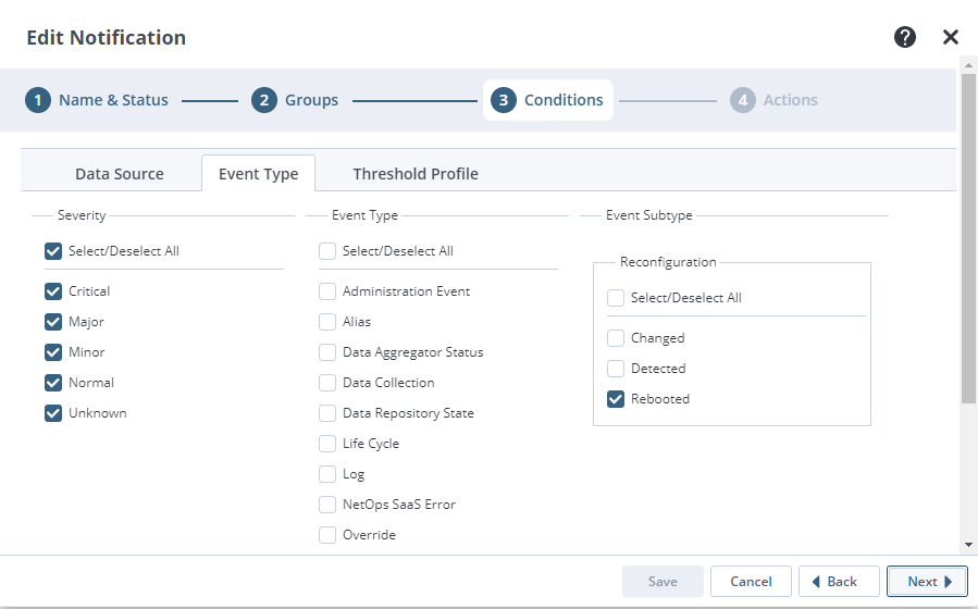

    Today I tried to use the similar way to trigger alerts for some other events such as device rebooted. At first I used email notification and put something like
    {ItemName}, {EventDesc} {EventType} {EventSubType}and I did receive email as expected when devices rebooted.

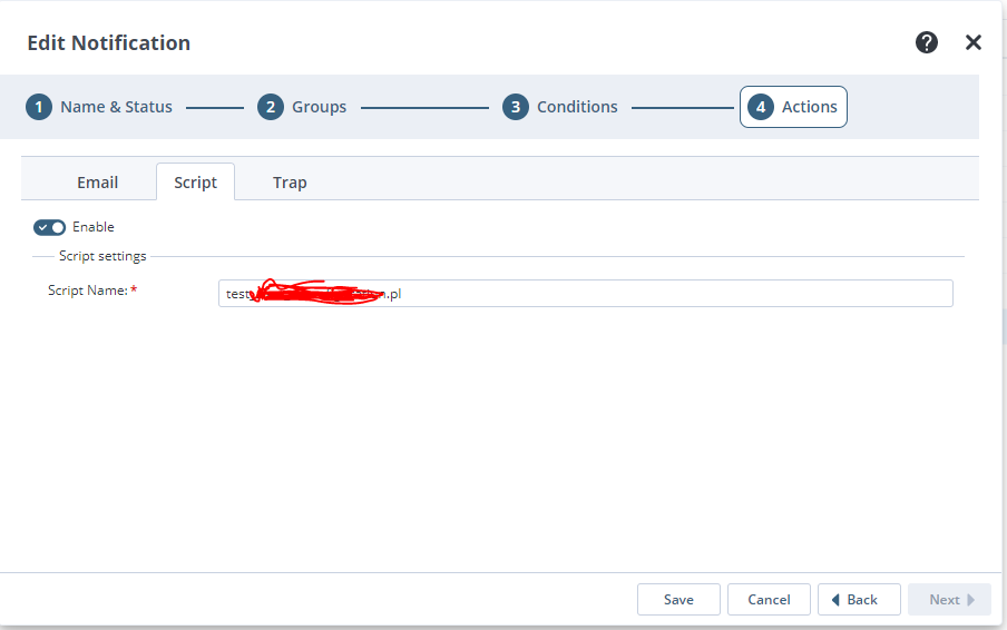

    Then I create a new script to do same thing(follow the same way we did for threshold profile), and as the TechDoc instructed, reference some values such as :
    $node = $ENV{'CAPM_ItemParentName'};
    $subcomponent = $ENV{'CAPM_ItemName'};
    $message = $ENV{'CAPM_EventDesc'};
    $eventtype = $ENV{'CAPM_EventType'};
    $eventsubtype = $ENV{'CAPM_EventSubType'};
    However I didn't get any alerts. Before sending alerts, my script write the info to my log file, however, I could not find such events in log file either. That means it didn't even trigger the new script I put under /PerformanceCenter/NotificationScripts/
    I'm wondering if NetOps uses different way for other event types such as "reconfiguration",  "Administration Event"... ?

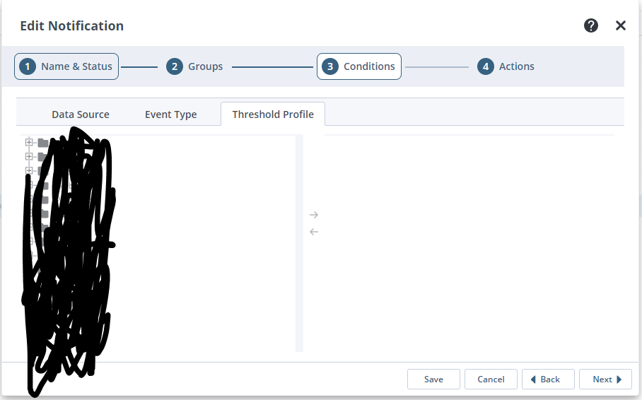

    If you click on the Threshold Profile tab, are there any profiles/folders add to the right side?
    If so, remove them.  If they are there, it means only events for those threshold profiles will pass the filters.
    And the group you applied to the notification has the devices that have the reconfig events?

    We do have a lot of folders/profiles at "Threshold Profile" page. They are main alerting for us so I cannot remove them. They are using similar script and have been working for years.
    I do apply all groups/devices for testing purpose and send to a testing queue to avoid annoying others. And I did observed "rebooted" events from CA PM Event page. Also if I use email as notification action, it works and I get emails.
    Is there a way to trigger such notification w/o deleting our existing threshold profiles for "reconfiguration" types of events?

    Sorry, not asking to remove actual Threshold Profiles from DA admin views.   I was referring to the Threshold Profile tab in the notification creation/editor under stage "3 Conditions".  See it the above screenshot you provided?
    We want to make sure NO threshold profile/folder is selected for that tab in notifications.
    We should not be touching Threshold Profiles under DA Administration pages.

    Yes when I checked the threshold tab from notification "condition" config, they are actually grayed out(additional screenshot attached here). I believe because I selected the event type like the screenshot I put with my question above, make them grayed out automatically.

    Thanks Jeff, with your hint I guess one step closer now, at about the same time I found this from EMService.log:
    Encoding: UTF-8
    Content-Type: text/xml
    Headers: {}
    Payload: <soap:Envelope xmlns:soap="http://schemas.xmlsoap.org/soap/envelope/"><soap:Body><ns5:PushResponse xmlns:ns2="http://netqos.com/nqevents" xmlns:xs="http://www.w3.org/2001/XMLSchema" xmlns:ns4="http://netqos.com/nqevents/filter" xmlns:ns5="http://netqos.com/nqevents/EventManager" xmlns:ns6="http://schemas.xmlsoap.org/soap/encoding/"/></soap:Body></soap:Envelope>
    ERROR | pool-4-thread-1 | 2021-07-28 11:53:43,809 | com.ca.im.portal.em.notifications.ScriptHandlerImpl
    | Failed to execute script java.io.IOException: Cannot run program "/****/***/****/PerformanceCenter/NotificationScripts/test_aaaaa_abcdefghijk.pl": error=2, No such file or directory

    And from there on the CA PC server notificationscript folder, I searched the script name by copy paste to the log file, and matched identical, all lower case. Also compare to other working scripts(the red scratch one is the one I am working on), file attributes are same:
