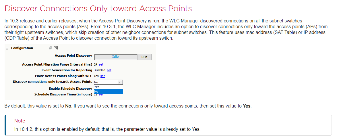

    Yes, there is the option to disable it.
    https://techdocs.broadcom.com/us/en/ca-enterprise-software/it-operations-management/spectrum/10-4-3/managing-network/wlc-manager.html

    Hi Silvio
    What I understand from "Discover Connections Only toward Access Points" is that it limits the connection discovery to ONLY the switch that the AP has a direct wired connect to.
    This is exactly the connection that I don't want Spectrum to discover.
    I don't want Spectrum to discover any connections to the AP's as it creates off-page references all over the Topology views and makes them very messy.
    I have tried this setting at both Yes and No and the connections are still discovered regardless
