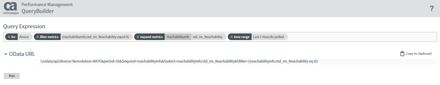

    Is there a way in the Odata query builder to find only those devices where the reachability has been 0 (Not Reachable) for a certain amount of time? I have tried this, however, I am getting devices with everything above 0 as well. Here is my Odata built query:
    http://da-hostname:8581/odata/api/devices?&resolution=RATE&period=1h&$expand=reachabilitymfs&$select=ID,HostName,PrimaryIPAddress,reachabilitymfs/im_Reachability&$filter=((reachabilitymfs/im_Reachability eq 0))

    I was able to get a query like this to work in an r3.2 lab we have in support.
    Changing the targeted reachability values, and time ranges, did change the data sets returned and it appeared at first glance they were only those that met the criteria.
    Mike

    Sorry, I should of specified PM 3.5. I too was able to get this to work about a year ago on 3.2. I think I just got it to work in 3.5. But I had to use the Aggregate filter function.
