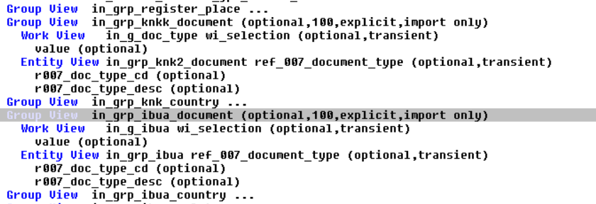

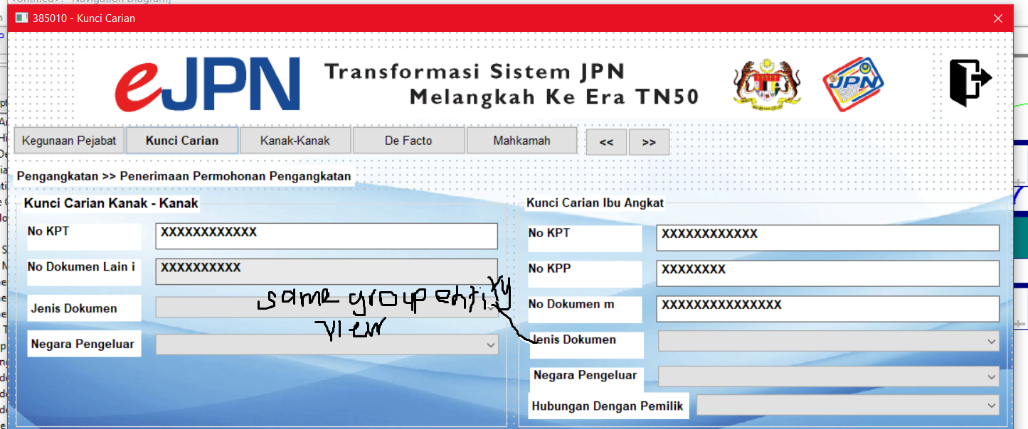

  • 9.  Re: internal fatal error
    Posted Apr 25, 2018 11:48 PM
    Hello Lynn,
    Did you mean like this one?
    In the screen the listbox is non-enterable, the group view is different but the entity view is the same..which is i read from the same group table database..
  • 10.  Re: internal fatal error
    Broadcom Employee
    Posted Apr 26, 2018 02:39 AM
    Hi Nur Amirah,
    Using the same underlying entity across multiple list boxes with different group view/entity view names as controlled by the toolset design should not cause such a problem.
    Per Andy/Steve's advice the root cause sounds more like at least one of those group entity views is maybe unknowingly being used elsewhere on the same window or a dialog box for that PStep.
    If you cannot locate the problem using that previous advice I would suggest to create a support case so we can help to analyse a copy of your model in more detail: https://comm.support.ca.com/csupport/CaseManagement/cases/new
    Thanks
    Lynn
