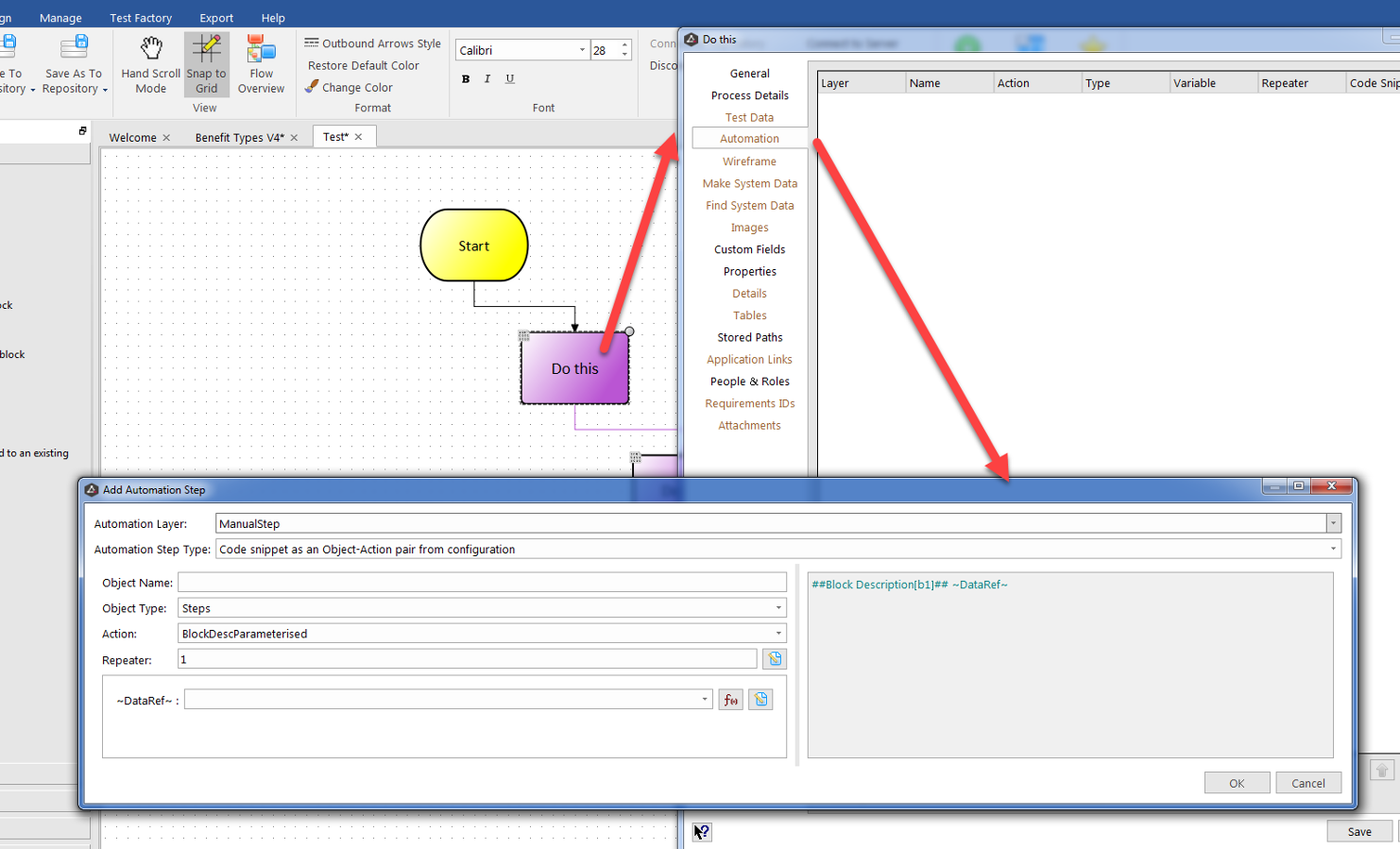

Workaround 2: Use the 'Automation' feature to create manual steps for users to follow, which can be interwoven with data.

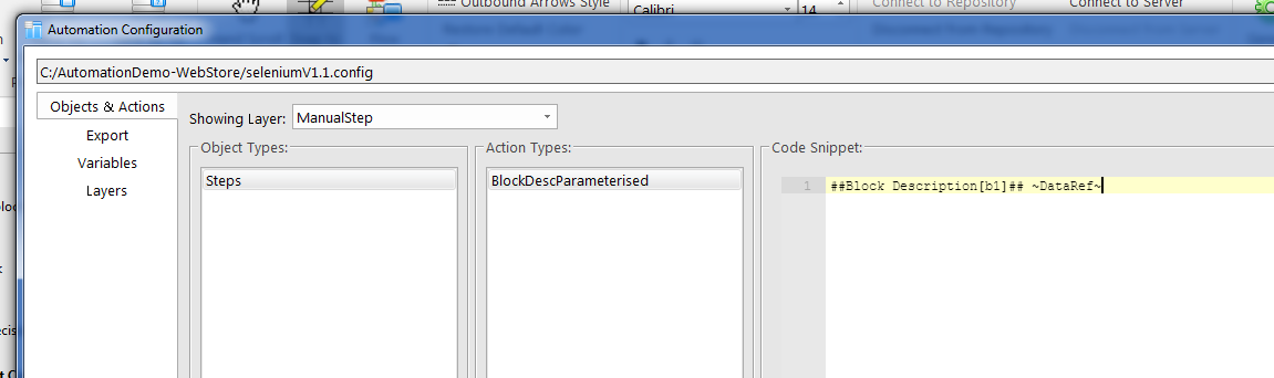

Since you can make new Automation snippets on a new 'layer' whenever you please, you can create an automation snippet that simply loads the block description, then allows for some data reference:

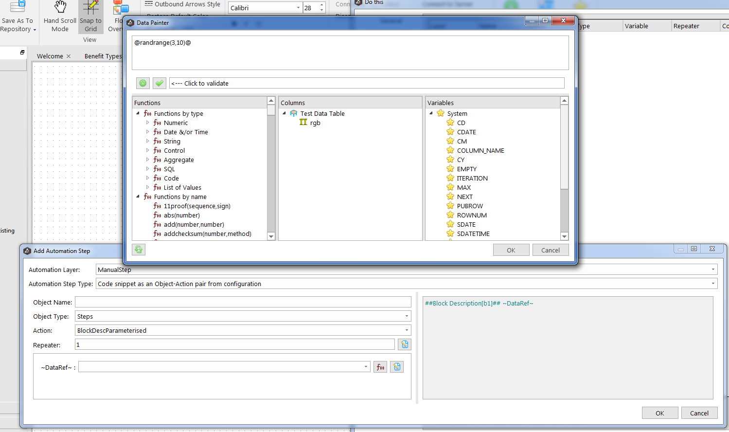

Then, you can add this to any block as usual, and provide a test data parameter value for ~DataRef~:

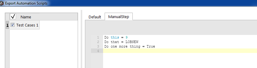

Then, once we've added the reference to all of the blocks, we can generate Manual scripts like so:
Also, it's worth noting, just as I suggested how one would upload test data per path to ALM, the same option is available for our new Manual scripts too!
Long term: I would agree, that all fields within ARD should be resolvable, which would allow you to write a description like: "Do this to ^that^, using the ^item^ for @randrange(100,500)@ ms".
