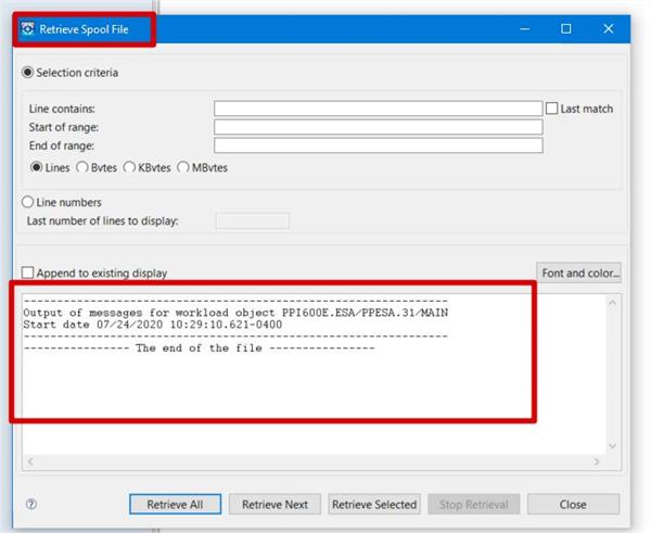

    Spool is not helpful.
    All we get for error is as specified above:
    Sqlcmd: Error: Microsoft ODBC Driver 17 for SQL Server : Login failed for user 'DOMAIN\SERVER$'
    The job definition is:
