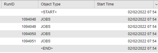

But if look at the activation times of the JOBS, everything is starting at the same time - which again I don't think is correct since there is a logical flow + dependency on the preceding tasks to end OK - there is even post-conditions on some of them.
