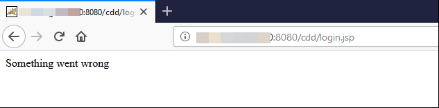

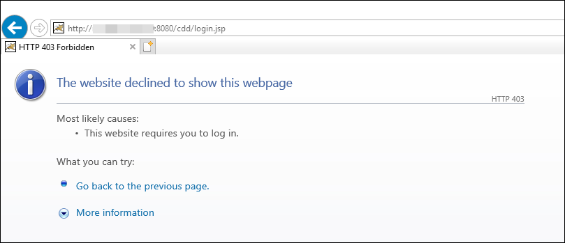

However, an error message appears, such as:
FireFox
Internet Explorer 11
You check the log and see an error such as:
2018-12-04 11:38:54.215 [http-nio-8080-exec-11] ERROR c.c.r.w.f.OriginVerificationFilter - Failed request based on its origin. You may clear the JSESSIONID cookie request header or logout from the related CDD session
com.ca.rp.exceptions.rest.ValidationException: Accessing '/cdd/login.jsp' is forbidden from 'http://cdd-docker-engine-3:8080/cdd/login.jsp', verified by referer header
