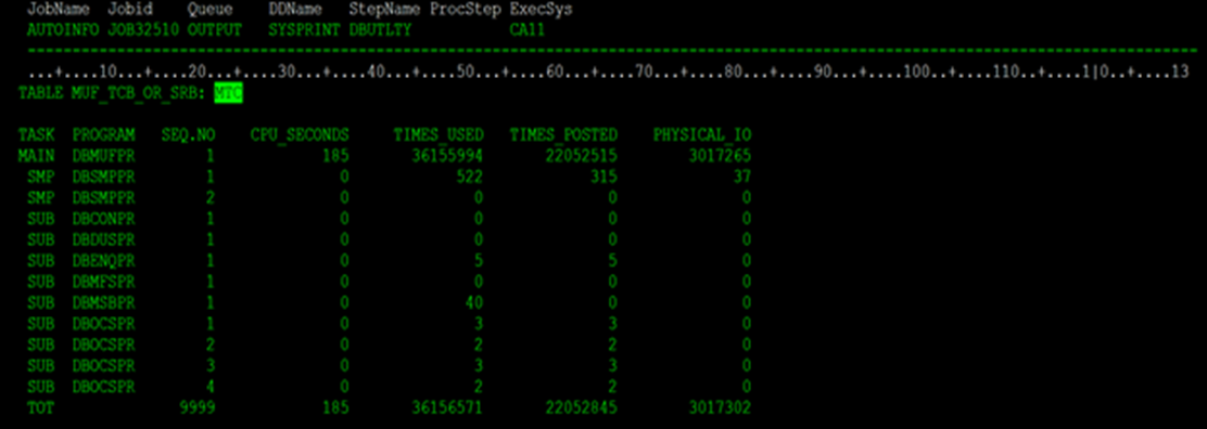

Snapshot 1. MAIN task (limited Symmetrical Multiprocessing) environment
The MUF executes with a single main task (TCB) that performs the majority of user request processing. Depending on the Release of Datacom, one or more additional SMP DBSMPPR tasks (TCBs) can be created to assist the MAIN task is user request processing. In this mode, the MUF determines whether the SMP task is added. The user has no control over its specification or use.
There are a number of other SUB tasks (TCBs) that are allocated to handle system tasks such as open/close, memory management, and so on.
Snapshot1 of tasks in a CA Datacom MUF executing with limited Symmetrical Multiprocessing enabled (SMPTASK start-up option is not specified)
Generally, this type of processing is used for smaller workloads where no zIIP offload is needed.
Note: There is no zIIP eligibility in this MUF set-up.

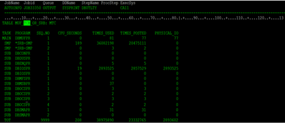

Snapshot 3. MUF running in a Symmetrical Multiprocessing mode (SRB mode)
For larger workloads where zIIP offload is needed, the MUF address space can operate in a Symmetrical Multiprocessing (SMP) mode utilizing both WLM SRBs and TCBs for database request processing. Consequently, the MUF has multiple pairs of SRBs and TCBs available for database request processing.
These database request processing tasks operate in parallel providing the ability to concurrently execute database requests. Typically, SMP processing is employed where there is a large enough workload to keep two or more tasks concurrently processing requests. While sites can specify large numbers of SMP tasks, the typical site runs with 3-5 SMP tasks.
The following MUF Startup option is used to start the MUF in SMP mode with SRBs and TCBs (zIIP enabled).
SMPTASK x,y,z,SRB
where:
x – Indicates the maximum number of additional SMP tasks that can be allocated for database request processing
y – Indicates the initial number of additional SMP tasks that can be allocated for database request processing
z - Indicates the amount of workload “ready to run” that must be in the queue before the MUF activates the next additional SMP task.
SRB - Indicates that all SMP tasks are started as SRB/TCB pairs.
Each pair has one SMP *SRB-SMP that executes the zIIP eligible portion of the request and one SUB DBSMAPR that executes the non-zIIP eligible portion of the request.
In this mode, the MAIN task is not used for user request processing and the SMP DBSMPPR (TCBs) are not activated. All user request workloads are directed to the SRB/TCB pairs.
As with main task processing, a number of other minor tasks (TCBs) are allocated to handle system tasks such as open/close, memory management, and so on.
Snapshot3 of tasks executing in a CA Datacom MUF with Symmetrical Multiprocessing with zIIP processing enabled (SMPTASK 3,2,4,SRB)
This type of processing is typically used for larger workloads where zIIP offload is needed.
Note: In this environment, zIIP eligibility is activated.

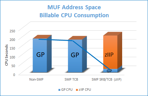

With CA Datacom Release 15.1, customer sites have regularly seen zIIP offload percentages exceeding 80% of the MUF address space CPU which greatly reduces the GP (billable) CPU use.
Graphic comparing GP CPU and zIIP CPU seconds consumed in each of the three MUF environments described above when running the same workload.
