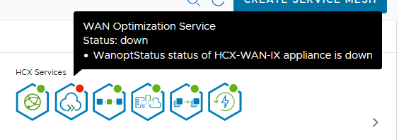

    I decided to write this post because it's been days Disaster Recovery Service is down after doing the 4.8.2.0 HCX update (local and cloud HCX).
    I installed all updates on 3 of our hcx appliances, such as:
    • HCX-WAN-IX version 4.8.2.0;
    • HCX-NET-EXT version 4.8.2.0;
    • HCX-WAN-OPT version 7.3.9.0.

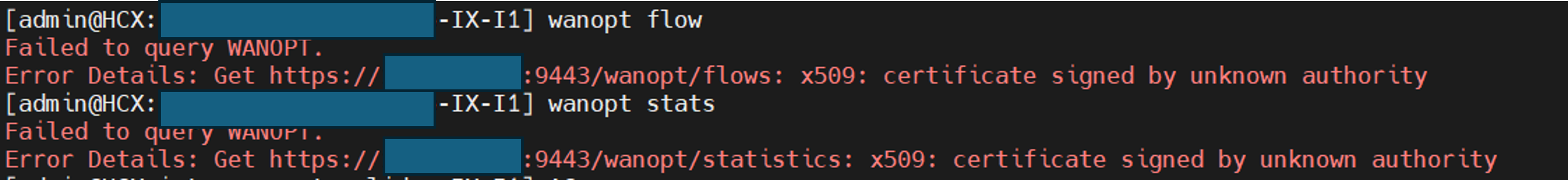

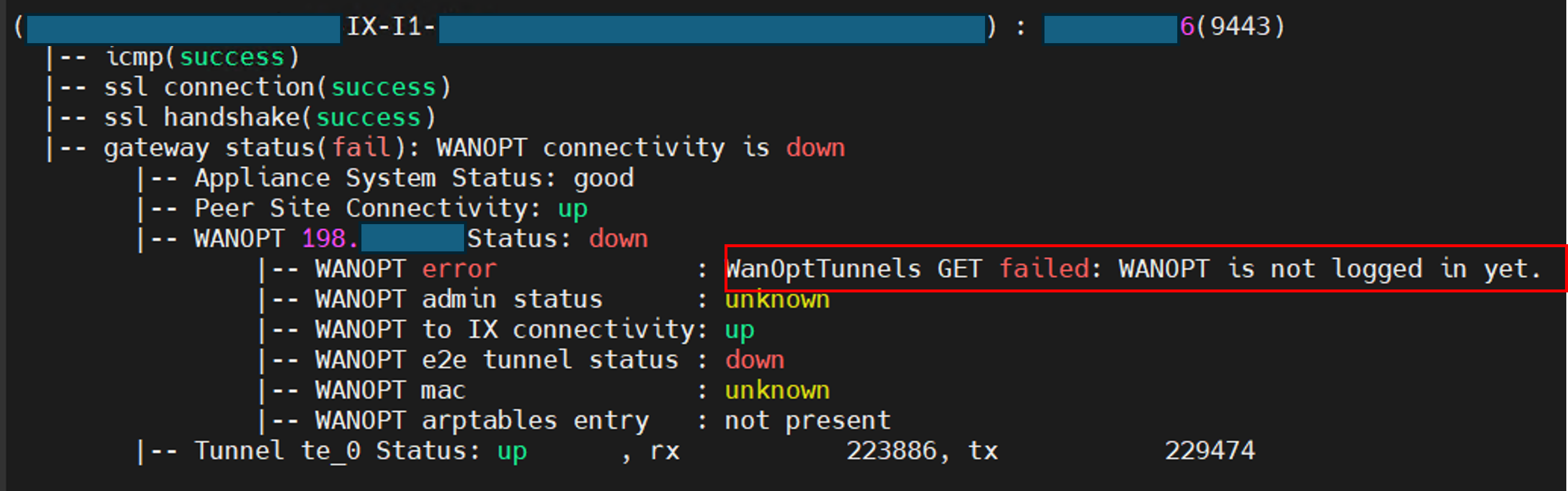

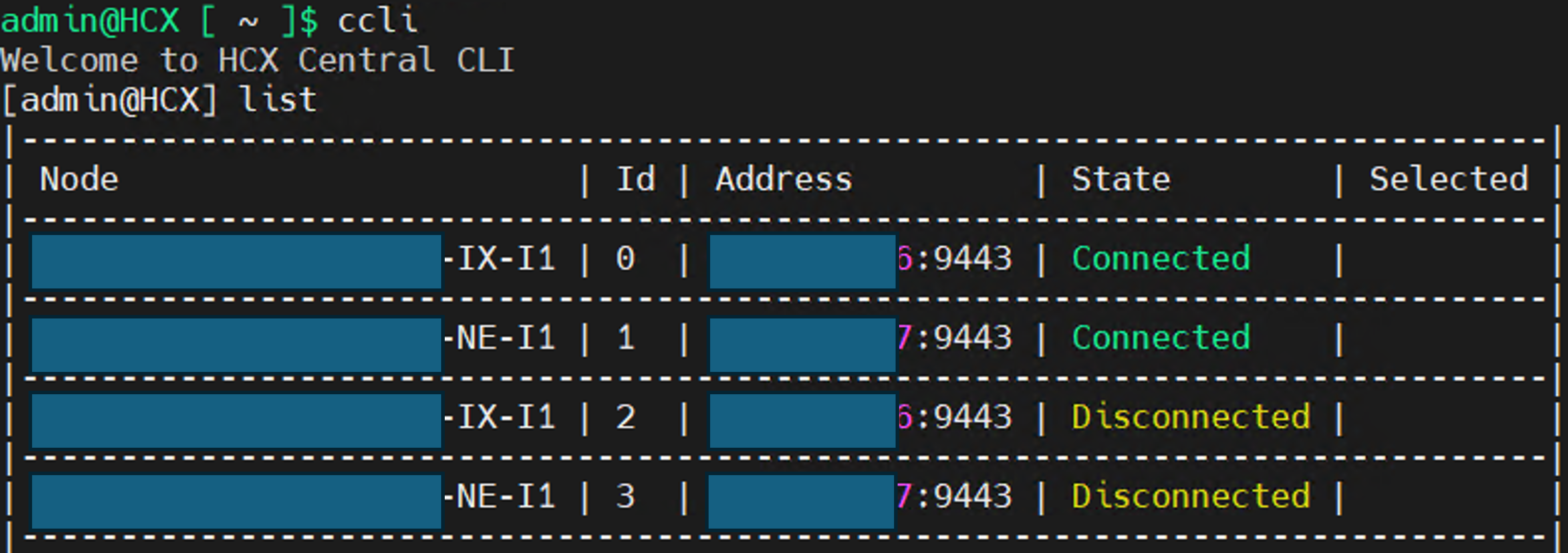

    5. From the HCX Manager, nodes IX and NE are disconnected ; And WANOPT status is down.
    WANOPT error: WanOptTunnels GET failed; WANOPT is not loged in yet.

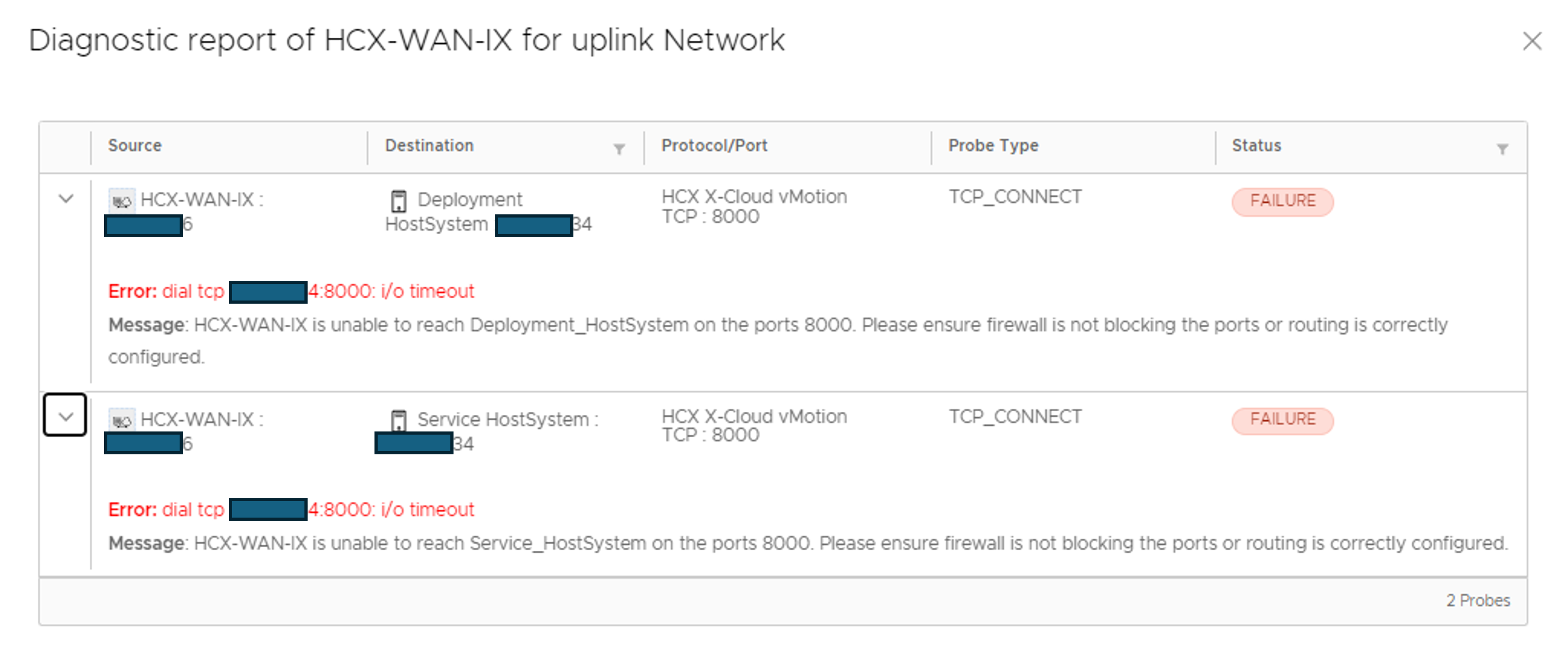

    6. Run a diagnostic and I'm having this result:
    In addition, Site pairing between our local hcx and the cloud hcx is up.
