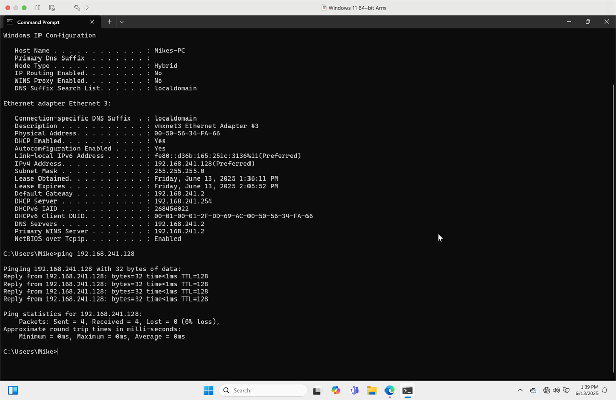

In the Windows guest, open a command prompt and run:  ipconfig /all
I went ahead and did this, and then pinged some of the ip addresses and it seems to be responding (see screenshot below):
Let me know if there is anything else I can do while you look at the logs!

It looks like now you're connected via a bridged connection (the IP address shown in the screen shot doesn't match the NAT network or the host-only virtual network configurations). It looks like you got an IP address for the VM, a gateway, and a DNS server. My assumption is that the gateway and DNS server are for your router (and should be the same as you find from the Mac).
Your ping output in the screen shot shows that you can ping the virtual machine from itself. Let's try the following to see what's working and what isn't:
